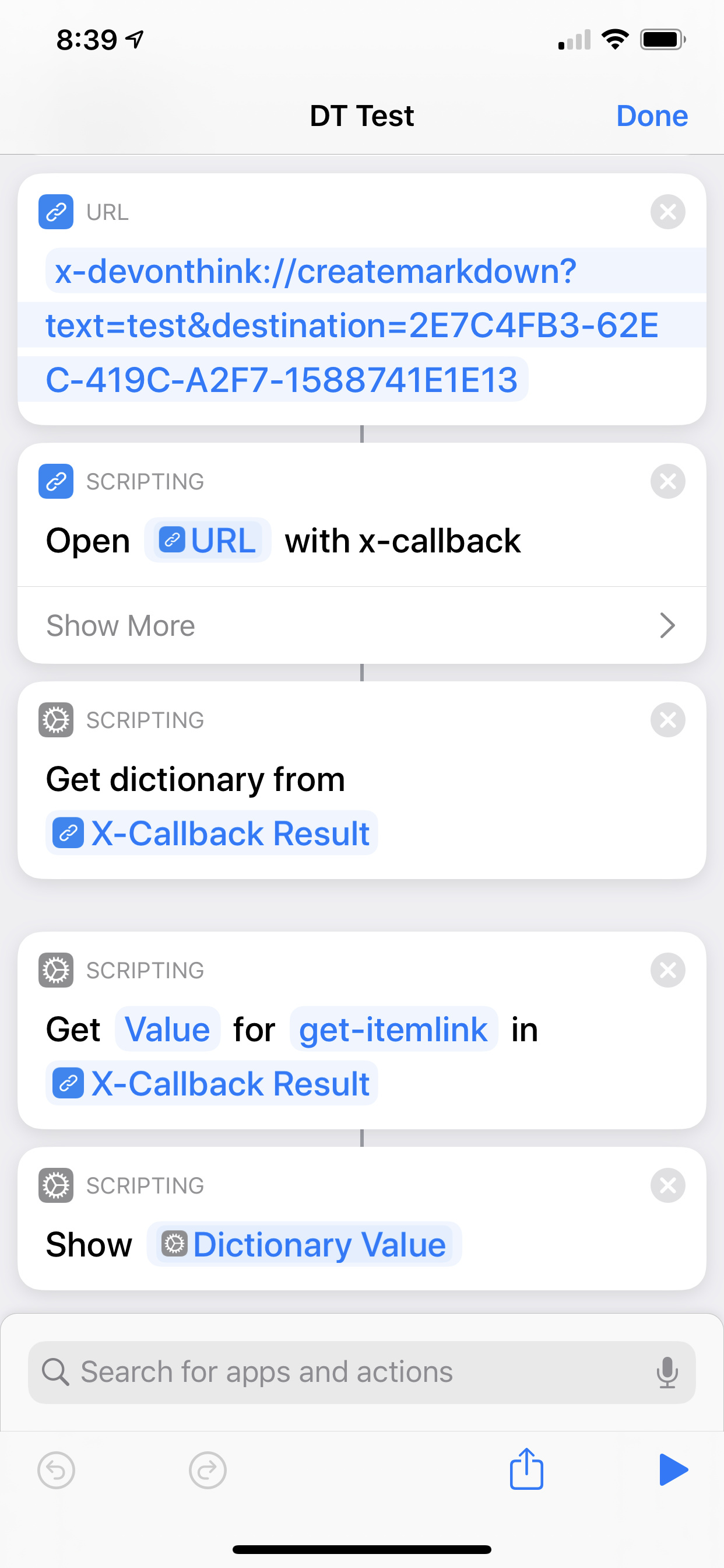

Here is a test I am running:
https://www.icloud.com/shortcuts/900bf7f85d8140eabd9eeabf8996e33c
I know this works with shortcuts others have built, but I can’t seem to get a return value.
Is there something basic I am missing to get the itemlink back as a success value? I know I can Get value from Dictionary but at this point I am just trying to see what is returned at all - that is why I am just trying to get the content graph (or show result).
Basically I am just looking to capture something into Devonthink and get an itemlink in return (to clipboard or some other destination).
Any help would be greatly appreciated.
  1. Though using an x-callback-url shouldn’t be used in all cases, it must in this one since you want a value returned to Shortcuts for inspection. Therefore your URL must be x-devonthink://x-callback-url/create…
  2. In this instance a dictionary is already returned, so just get the content graph of the return of opening the URL.
PS: You can also query the value explicitly, like so…
This small detail seems to be consistent throughout all the shortcuts I have that aren’t working. I thought it didn’t make a difference as long as I used the Open X-Callback action in shortcuts. I thought that was the trigger. I am wrong. Thank you. I will test and repost if that was the issue. But seems to be the case. Will this work with all item creations through the url scheme. In other words I can get the item link regardless of item I add? Or is it limited to certain file types?
itemlink is returned in any creation command with an x-callback-url.
