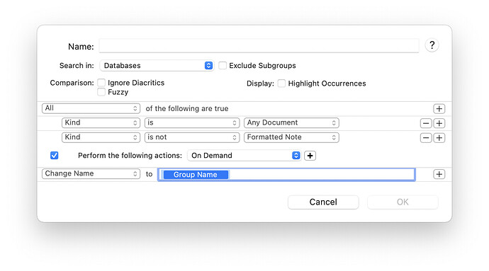

A smart rule is actually sufficient:
Awesome! Thanks.
It’s easy when you know how isn’t it!
Location group worked thanks.
