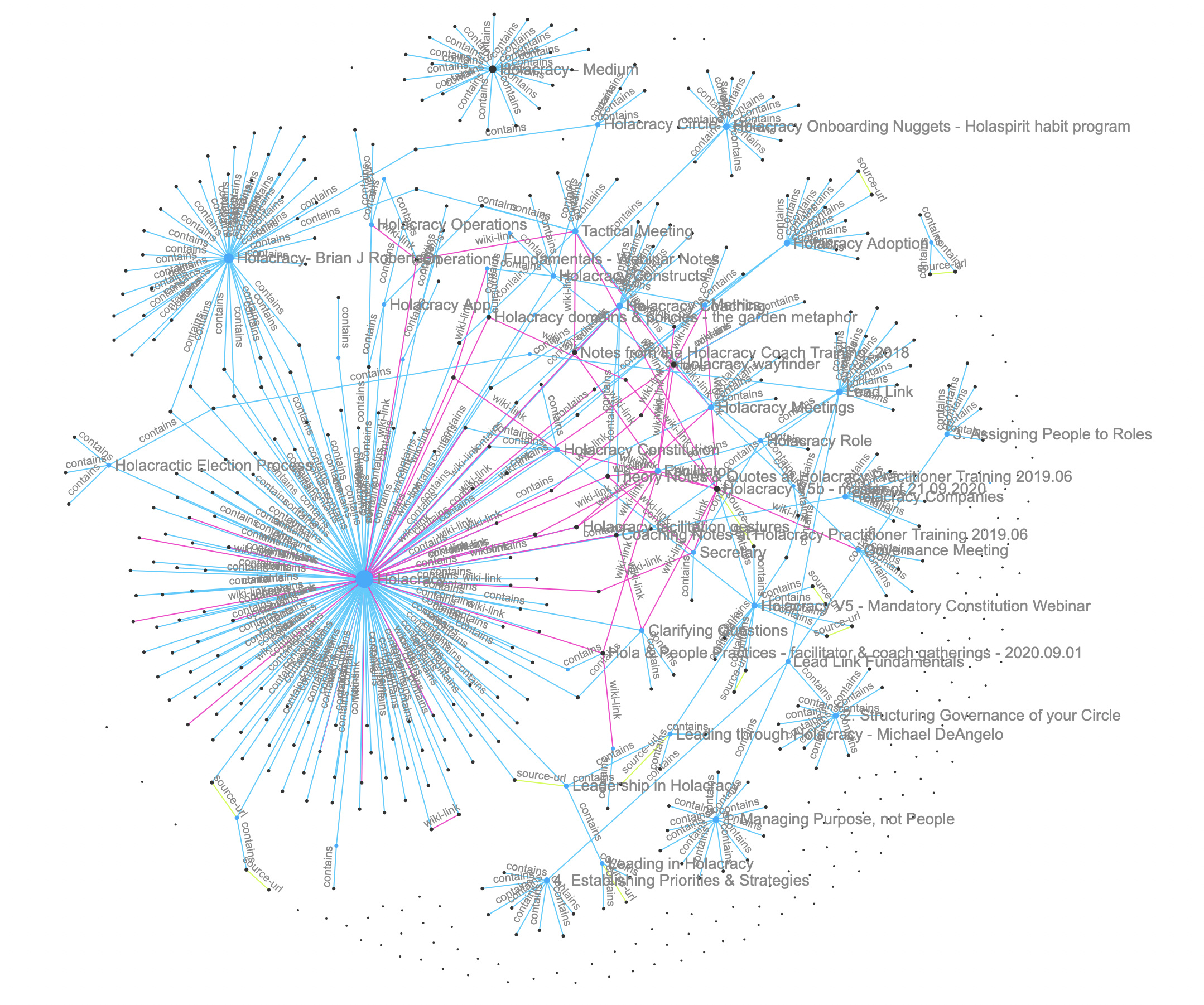

A few updates on this script:
  • It now is more robust : instead of injecting data in an external file, it generates a HTML file for the graph in your global Inbox. Which means if the graph were buggy, just send it to me in PM for analysis.
  • it covers now three types of links: wiki-links in markdown files (pink edges), x-devonthink-item links in URL of record (green edges), and parent-child relationships (blue edges).
  • the rendering got faster (on a boosted MBP13): (40 nodes, 50 edges) in (3s generating+ 1s layouting), (200n,150e) in (8s + 5s), (500n, 450e) in (35s+8s).

Some snapshots
