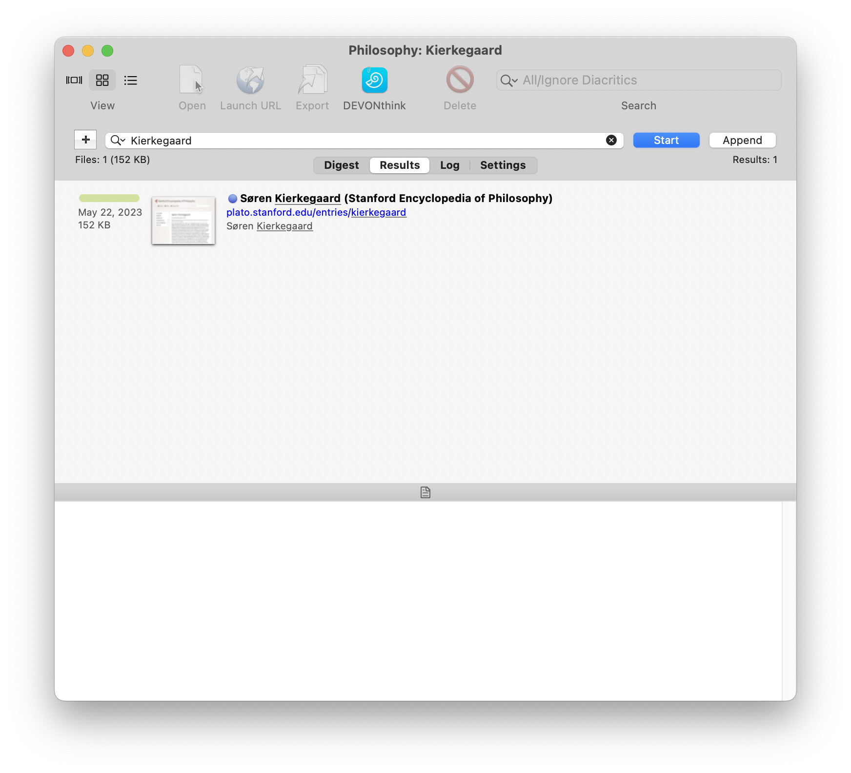

Has the Stanford Encyclopedia of Philosophy broken the DA plugin?
I’ve just noticed that the Philosophy plugin no longer seems to return results. Anyone know what they’ve changed at plato.stanford.edu and whether there’s a manual edit I can make to the plugin to work around? I know it’s a Red Queen’s race trying to keep up with all the under-the-hood changes to search implementation on these fast-moving resources.

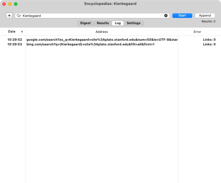

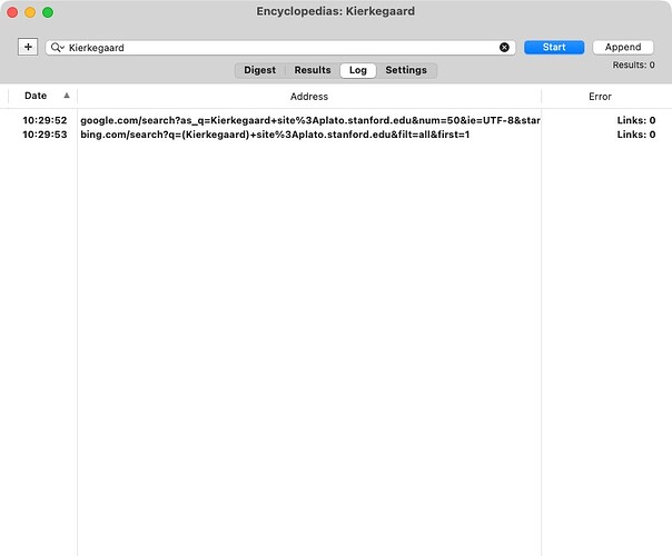

Thanks so much! Strangely, though, that version behaves the same for me as the built-in one, returning no results:
It must be something at my end. But what?
That doesn’t appear to be my plugin.

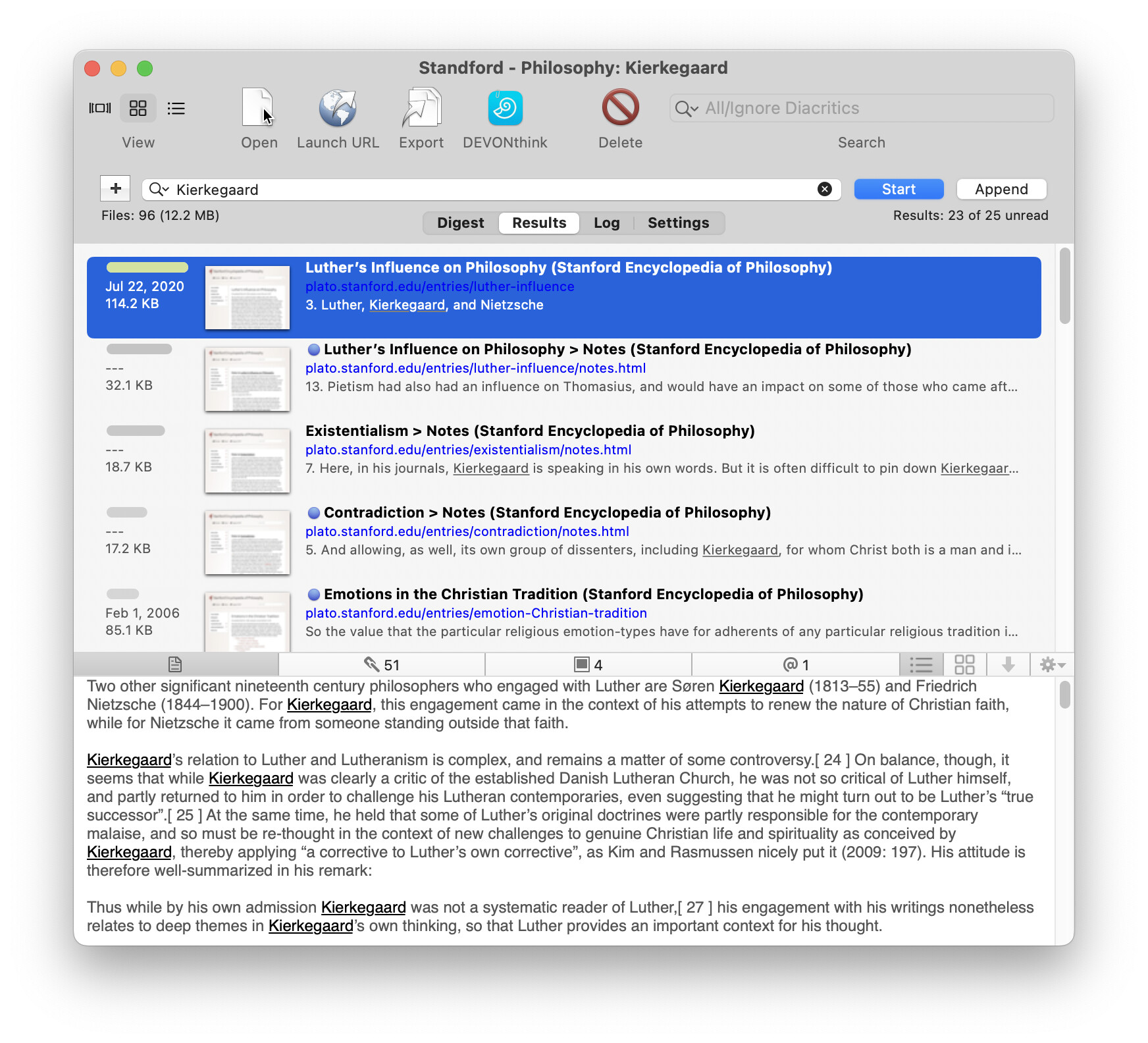

You need to unzip my attachment and put the .plist file in ~/Library/Application Support/DEVONagent/Plugins. Here is another search…
Weird! I re-ran the same search and it worked this time… I must have reverted to the old plugin without noticing. Huge thanks for going to the trouble of rolling the new plugin; for anyone curious, the key difference from the built-in version is that the LinksMatching string is *plato.stanford.edu/search/r?entry=/entries/* instead of *plato.stanford.edu/entries*. (There’s also no longer a KeywordsUrl string, which in the built-in version is http://plato.stanford.edu/search/searcher.py?query=_agentQuery_, but that doesn’t seem to add anything; I did try changing the http:// to https://, but it didn’t have any effect.)
