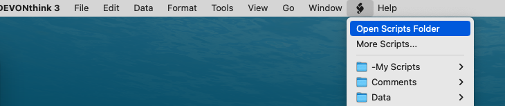

Devonthink installs a great selection of sample scripts
Open the script folder in Finder, and open any script in the Script Editor app

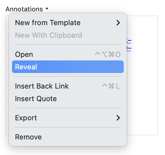

You can open an annotation file separate from the Annotations & Reminders inspector.
Click the flyout arrow next to the Annotations field and choose Reveal.

This helped me solve almost everything, thanks! By the way, is there a path to customize where the annotation goes? When I clicked on reveal, it created a folder outside the place where the PDF is located.
Oh, also is this still the way to create templates for those annotations from the inspector?
At which point, you can move the annotation record to your desired location
