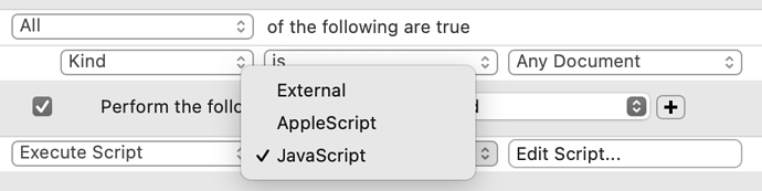

And JavaScript has built-in case functions, so you could choose JS rather than AS after Execute Script,
and in the Edit Script panel, paste or write:
performsmartrule = records => {
    records.forEach(r => {
        r.name = r.name().toLocaleLowerCase()
toLower.dtSmartRule.zip (1.1 KB)
Incidentally, FWIW, those outer braces are redundant in that context, so if it seemed cleaner, it would be fine to just write:
