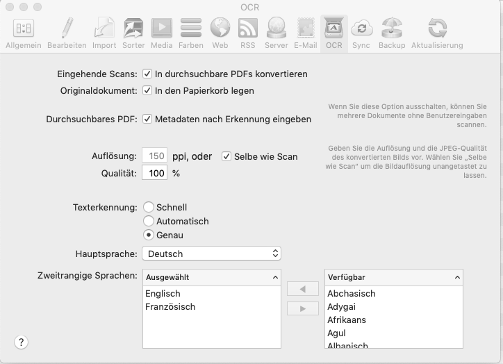

What are your resolution and quality settings in DEVONthink’s Preferences > OCR?

You shouldn’t use Selbe wie Scan unless you know the resolution a file was scanned at. It’s best to set a maximum resolution yourself, but we suggest no more than 300 and optimally 200dpi.
There isn’t an easy way to fix these files. I would suggest deleting and reimporting them. If you’re going to do OCR again, adjust the settings first.

My experiments showed that at 300 dpi the OCR was clearly less accurate compared to setting the dpi to „same as scan“. Then 200 dpi would be even worse.
The Quality setting did not have that much of an influence and 75% seems to be fine.
