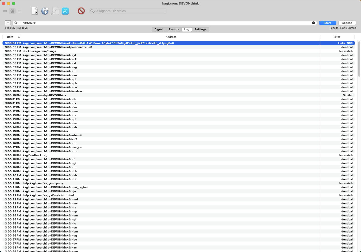

I have attached screenshots of the results, the log, and the settings panes. I have also attached a slightly modified version of the plugin (with the CrawlDelay and the access token placeholder included).

I also think you should choose a language in the settings tab instead of using International. The log from your first post looks like… the same search is performed for every language/region! (the &r= parameter) Your screenshot above could be the same, but I can’t tell. Are you in Uruguay or is that just a random results page?

What do you mean by “the first set”? Seeing the log and the results tab is honestly more useful.
