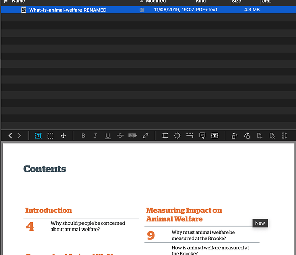

Indexing works fine into both databases, but once I rename in DB1 the PDF in DB2 shows as missing.
13%20pm|576x500
