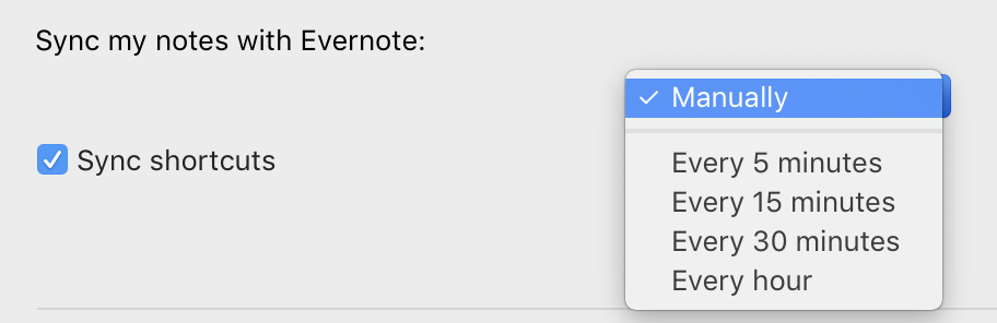

I don’t use Evernote of course :slight_smile: but according to its preferences it’s synchronizing like this:
And what do you think that means, Christian? Shortcuts are just links to frequently-used notes, so that you can access them from the sidebar. There can be up to 5. It doesn’t mean that syncing is somehow cutting corners …

Please look at the entirety of the screencap posted. He’s pointing out that Evernote has the same essential Sync intervals as DEVONthink.
