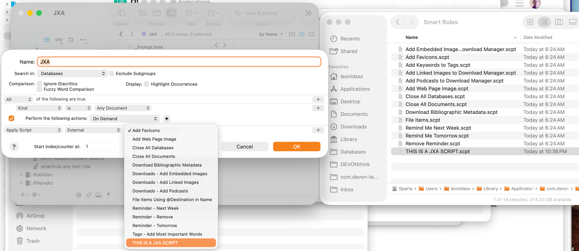

I would prefer to have the script be loaded from an external file but ran into issues when adding my script to the ~/Library/Application Scripts/com.devon-technologies.think/Smart Rules folder.
I first tried to add a sub directory, but that wasn’t recognized in the drop down in the Smart Rule editor.
Fair enough, so I added my script at the top level with the other scripts already there, using a prefix to visually separate my script from the others.
I tried adding the .js file, containing the working code used in the in-line version of the smart rule, but that file didn’t show up in the menu.
Next, I manually changed the suffix from .js to .scpt, then the file showed in the menu, but quickly produced an error on performSmartRule (A "/" can’t go here.) which I believe indicates that DEVONthink is running this as an AppleScript.
Finally, I took the script and compiled it into a scpt file in Script Editor with the language set to JavaScript, and … that works as an external file from a smart rule!
When I look at this file in BBEdit, it has some non-ascii characters at the end of the file and that seems to contain the magic sauce.
Can someone please tell me if this is the only workflow to get a JXA script with a .js file type to load externally from the Smart Rules folder.
It should be a .scpt file.

In all cases I am talking about setting the file type extension to .scpt instead of .js.
If I do this manually, the script doesn’t show up in the drop down in the Smart Rule editor, as described.
.scpt files certainly do show up in the popup, regardless of the language used.
I agree.
Does that also mean that .js files and subfolders do not show up, as I have experienced, by design?
The mystery to me is that since JavaScript isn’t really compiled, it’s interpreted, then I would expect that I could just rename a .js file to .scpt to meet the design requirements and have it run.
But it seems that I actually need to “compile” it in the Script Editor.
Is that the case?

The extension .scpt indicates a compiled script. And the compiled code does contain a language indicator.
So, there’s no way to have a text file with whatever extension as an external script.
That’s one reason why I never use them in smart rules. Also, external scripts might be cached, which makes developing/modifying them more trouble than with internal scripts.

The next release will also support scripts having the extension .js, e.g. in the Scripts menu but also by smart rules and batch processing.
That will be very convenient - thanks!
