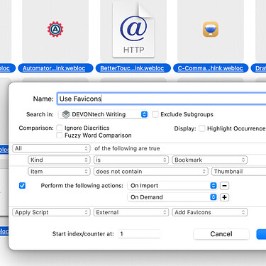

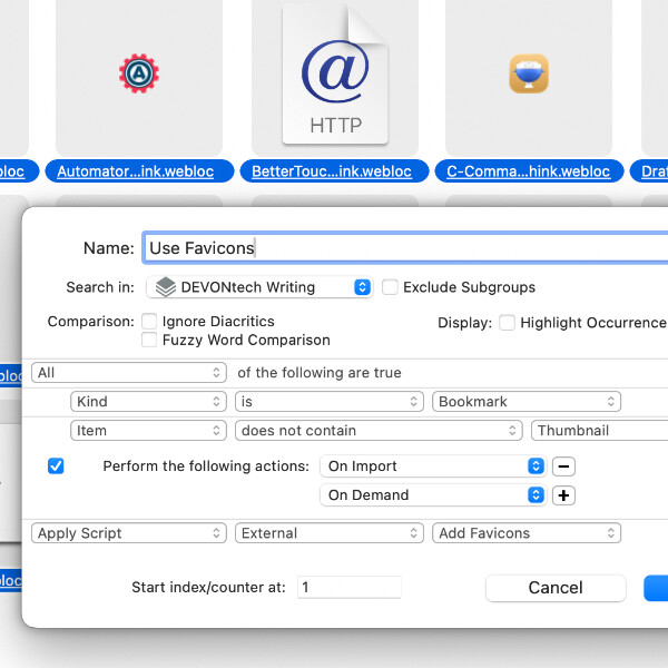

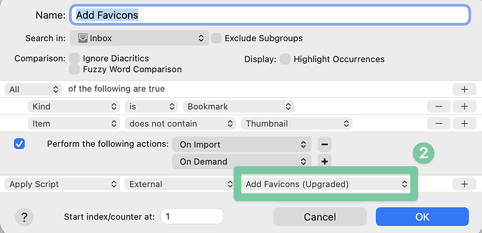

If you’d like to use the favicon for future bookmarks, you can create a smart rule.
  1. Select your database in the Navigate sidebar. At the bottom of the sidebar, press the plus (+) button and choose New Smart Rule.
  2. The Search in popup will target the current database. You can change this to Databases but make sure you want this to affect all bookmarks added to all databases before you do.
  3. Add criteria: Kind is Bookmark and Item does not contain Thumbnail.
  4. Add the On Import event trigger.
  5. Set the Apply Script > External > Add Favicons action and press OK.
Add a bookmark to the database and the smart rule will attempt to change the thumbnail to the site’s favicon. But note: Not every site will return its favicon so this isn’t a 100% solution.

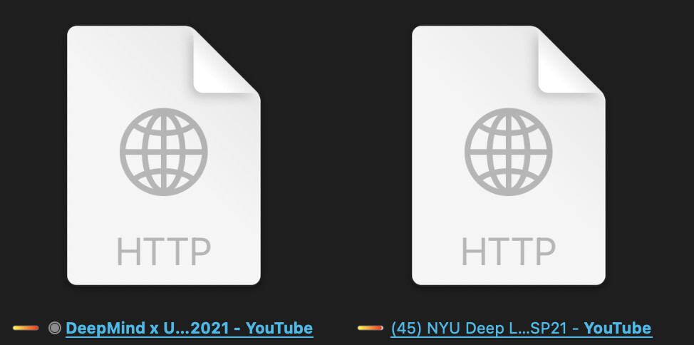

QQ: is there something which can be done specifically about Youtube Favicons?
I tend to have a bunch of Youtube bookmarks, but those do not seem to work at all in my case.
P.S. I did read the caveat that this is not a 100% solution :slight_smile:
Nothing in the current version of the script. Perhaps it could be looked into at some point but it’s low priority at the moment.

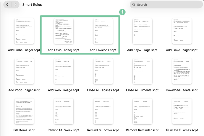

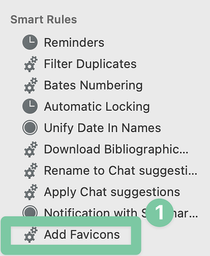

How To Install
Installation instructions

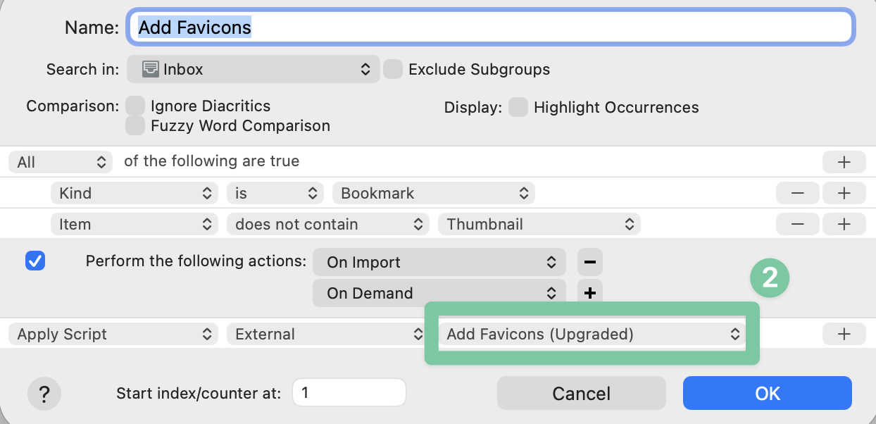

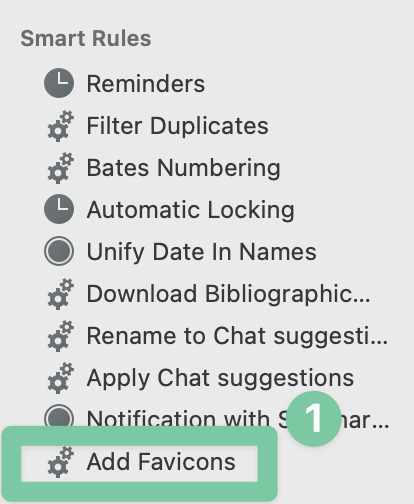

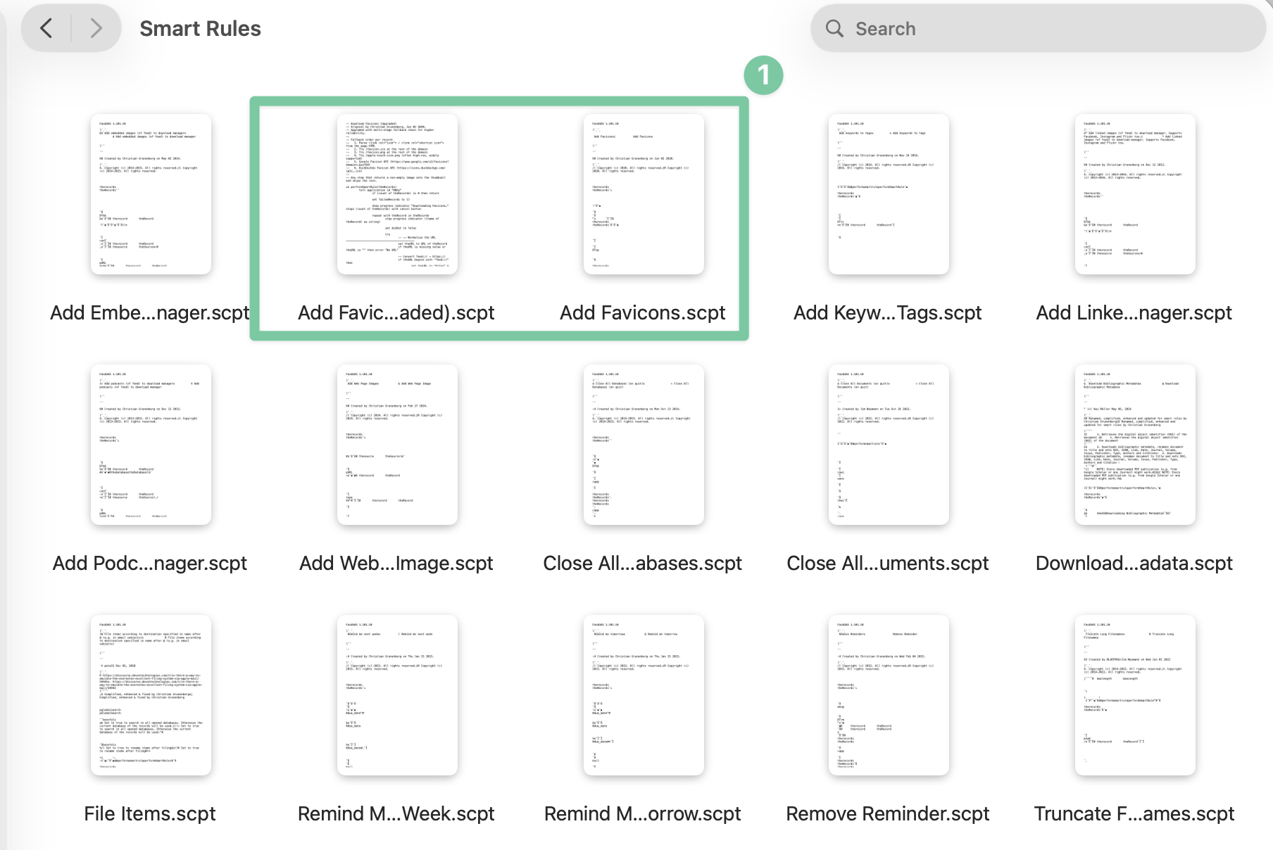

  1. Replace the existing script at: ~/Library/Application Scripts/com.devon-technologies.think4/Menu/. You can safely delete the old script, or preserve it if you want.
  2. Change the Add Favicons smart rule at `Sidebar (Smart Rules) > Add Favicons` to use the new ‘Add Favicons (Upgrade)’ script.
