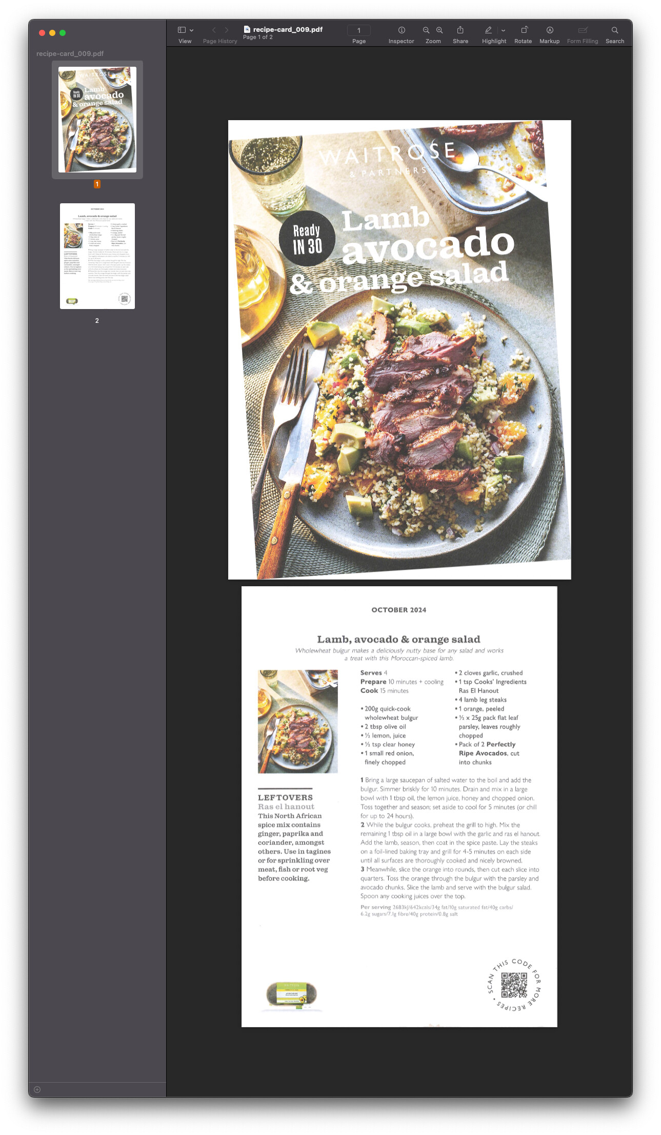

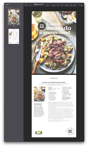

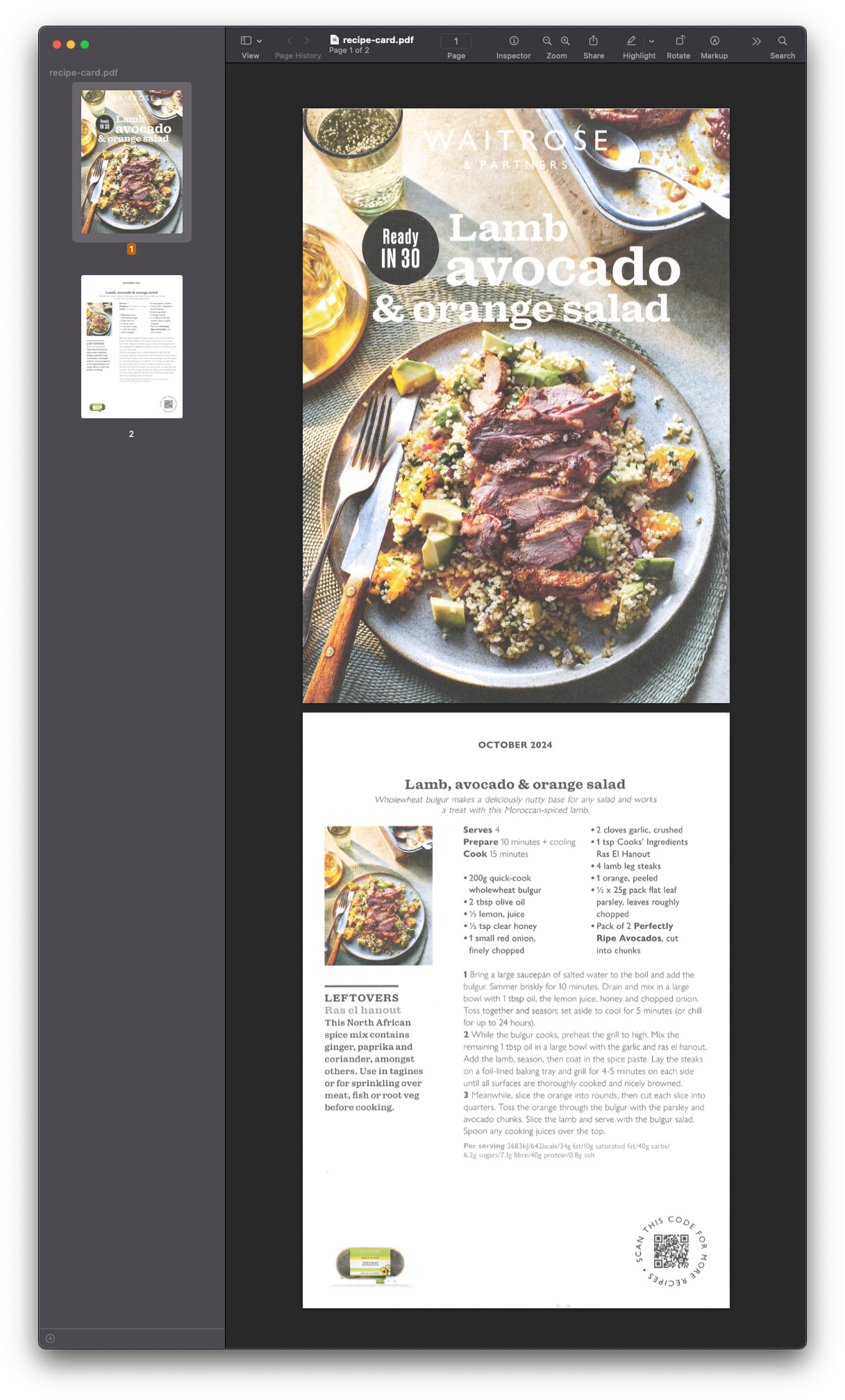

This is what it looks like in Preview before importing to DT3:
but after importing, it looks like this:
…and that’s clearly worse than before. (Others were more skewed; this is the first original card I could find — though it appears I misremembered about it trying to make the cutlery vertical!)
