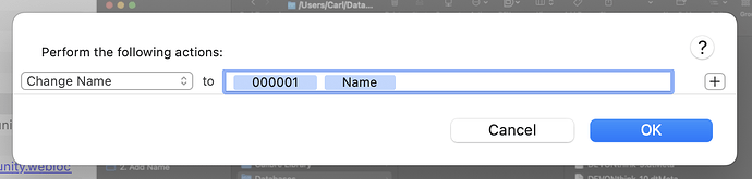

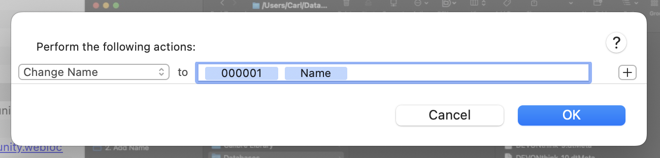

If the documents are in DEVONthink, you can select them all and use Tools > Batch Process and use the Counter placeholder before or after the name.
The counter will go from one to the number of selected items. So if you want them all uniquely numbered, select them all, not just a batch of them.
