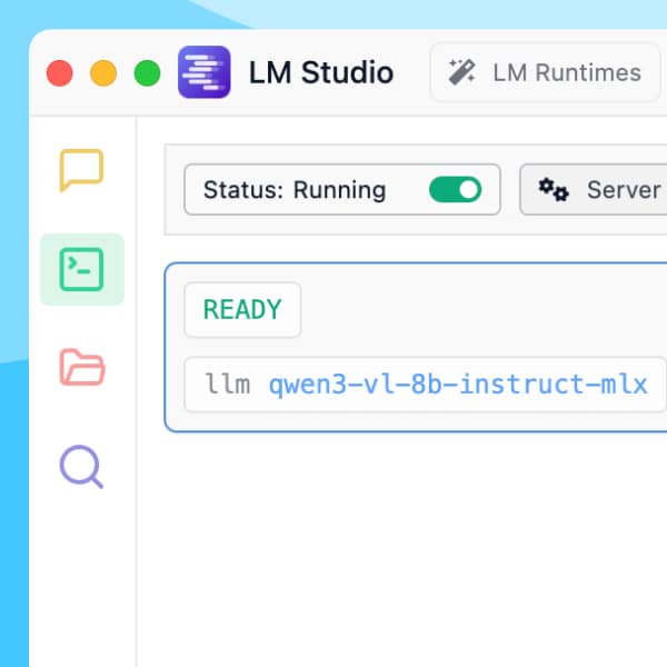

If Ollama is running, DEVONthink can chat with your local model through it. In LM Studio, click the Power User button at the bottom of the window, then the green prompt icon. Flip the switch to start the server and it should be available to chat with too. As a bonus tip, choose one app or the other but don’t try to run them simultaneously.

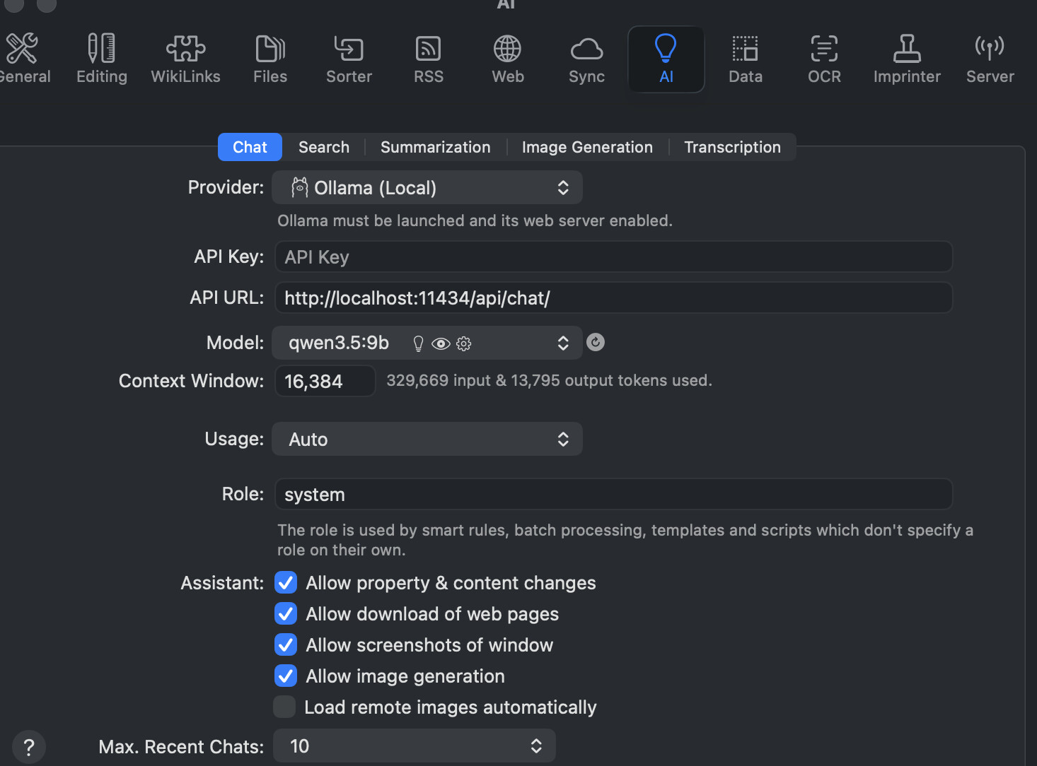

Hi - I have installed Ollama and Ouen but am having difficulty populating the dropdown in the AI settings so that I can select Ouen as a model. Can anyone suggest why this might be so?
You probably used the wrong URI in your settings. Not possible to say without more information.
Thank you — in fact I found that the problem was that I was inserting http:// before the address. For some reason DT doesn’t like that…
I doubt that that’s the reason. At least here, it likes http://localhost/whatever.
Post a screen capture of the AI > Chat settings with your URL filled in.
Here you go – it’s working now. DEVONthink added the “http://” automatically after I inserted the rest
