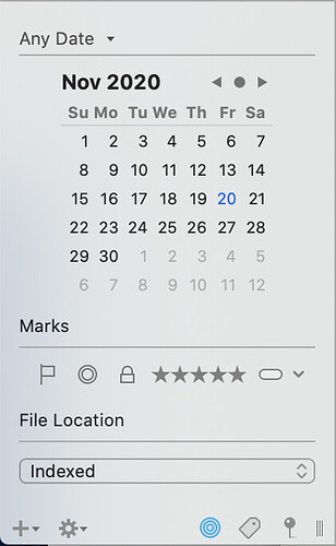

You can also use the File Location dropdown in the Info filter pane.

Correct. It’s in the Filter panes. See Tools > Filters.
Thanks, I’ll try that
This info filter pane looks interesting, but I can’t seem to find it. I did go to Tools->Filter->Info and nothing appears to happen in the UI - at least nothing which pops up this calendar and file location based on indexed vs. “unindexed”. Could I have a view setting that is preventing this from appearing? Or am I missing something. Thanks.
It appears at the bottom of the Navigate sidebar on the right side of the main window.

Why are you creating a smart group instead of using the File Location dropdown in the Info filter?
