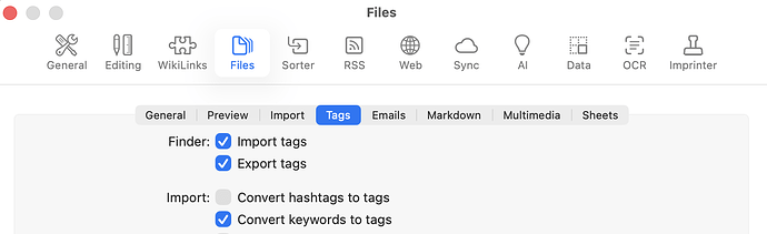

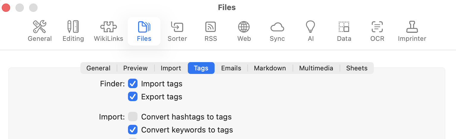

Is the option to import Finder tags enabled, see Settings > Files > Tags > Finder? And did you set the extended attribute before importing?
That was the culprit! Had to enable it. Now it works. Thanks.
Now the relevance of the script dawns on me: Does it do the same what the Convert Keywords to Tags setting does?
Unless I’m overlooking something, that script does nothing pertinent. It sets a variable to the kMDItemsKeywords and then does nothing with that variable.
@chrillek is correct; the variable isn’t used. It’s a code snippet showing how to query that type of metadata from a file with vanilla AppleScript.
