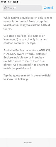

I do get search hints and they do mention Boolean operators as available. Should’ve looked closely from the start. I do not see the question mark in the search box though (even hints mention it, but it’s not there).
(The screenshot of the search tab from my iPad below)
As far as I know there isn’t an option to turn it off. It might return if you close DTTG (swipe upwards in iOS) and/or subsequently reboot your device.
If it doesn’t, perhaps @BLUEFROG knows what’s going on when the the question mark in the DTTG search box goes missing.
It’s back. Closing DTTG didn’t help immediately, but after I entered one of the databases and selected a note, the question mark has reappeared. Now it is available all the time, even if I close and reopen DTTG. I wonder what might have happened.
