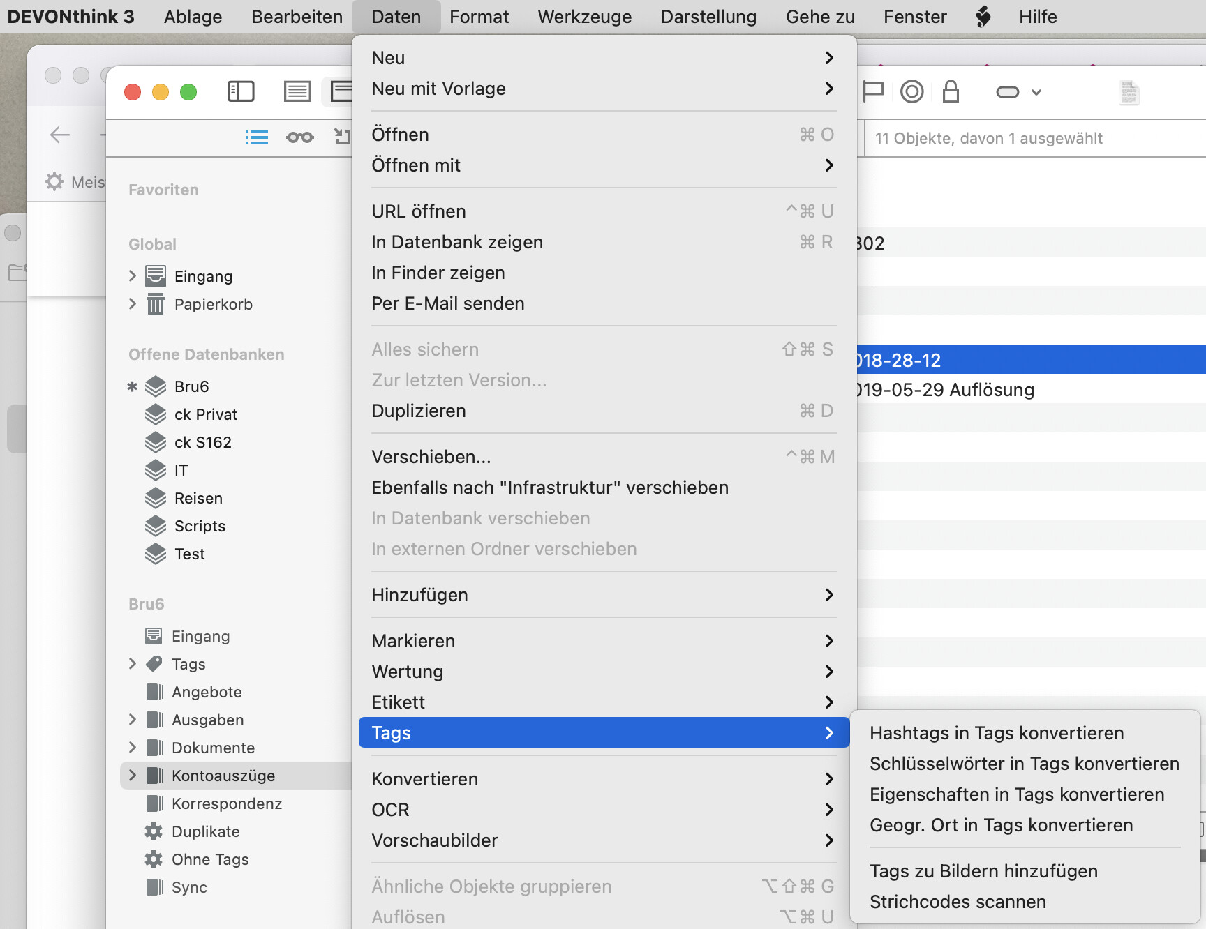

So what you could do is put the geodata into tags on the desktop using the built-in function:
Maybe that helps.
