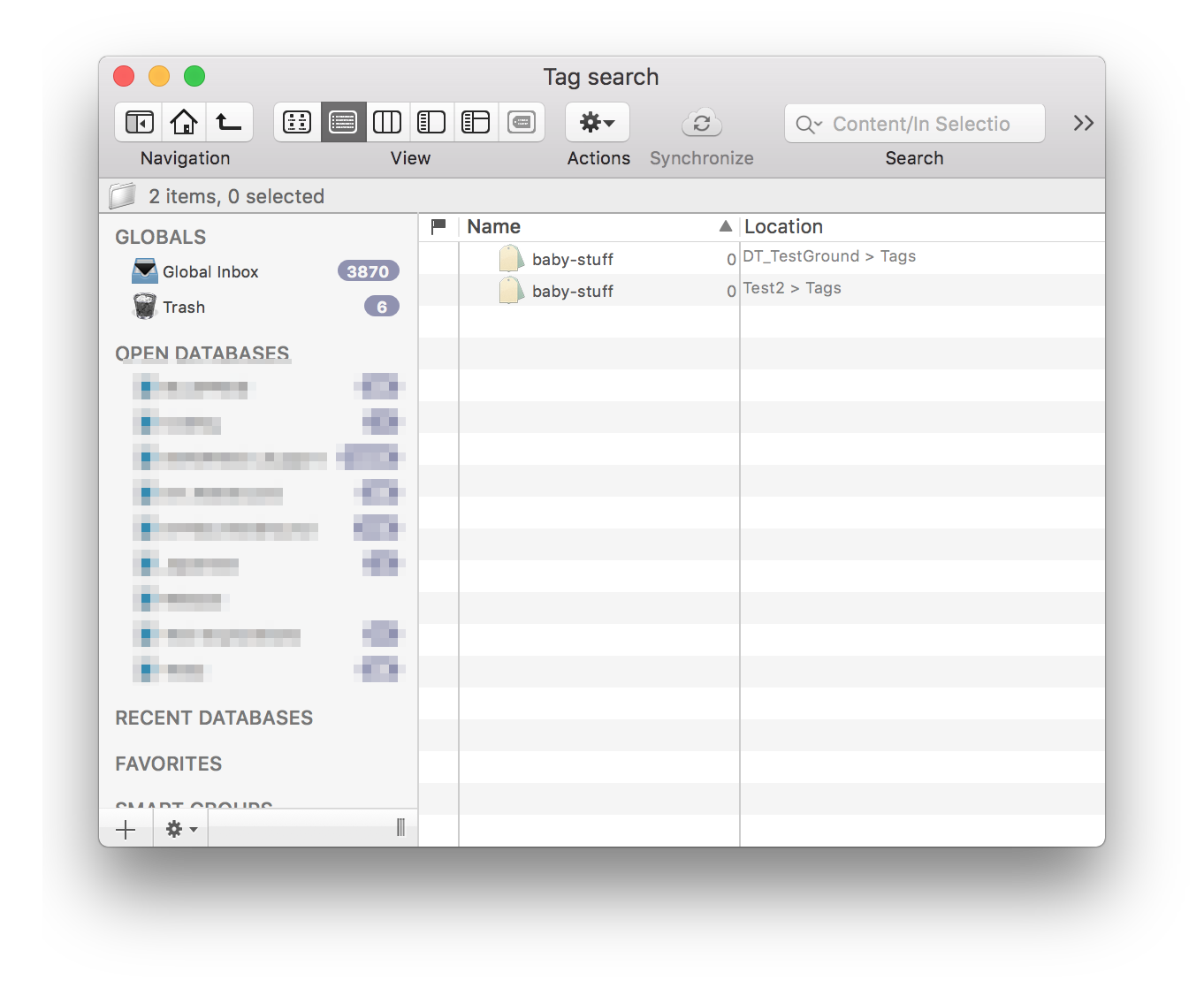

I try to find all tags with the name “baby-stuff” across my (open) databases.
To clarify, I’m not looking for documents with that tag, but for the tags themselves. (Maximum one per database I guess.) How do I do this?

You can’t specifically “list the Tags”.
You could try a smart group matching groups with the desired name.
Thanks Jim. - I will just do a search for the tagged documents, look at the loactions and infer the existence of the tag in the databases from that. Slightly cumbersome, but not to bad.

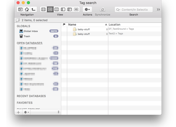

This is the result of the smart group I suggested.
Thanks fro the screen shot. That got me on the right path:

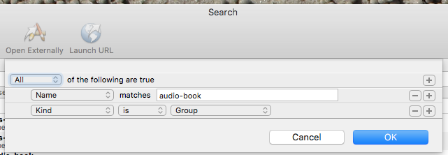

The trick is that tags are of the kind “Group”.
So the following search works to find all tags containing “audio-book”:
Of course if there are other groups containing the string “audio-book” they will be listened as well… I don’t know how to avoid this, but it is not too much of a problem.
Correct.
It can’t be avoided, as a Tag is a type of group, and not distinguished from other groups.
