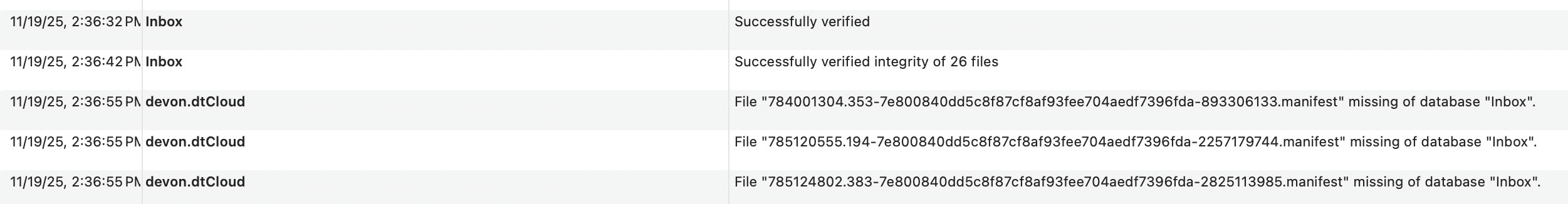

I have 2 Macs syncing to a WEBDAV share, and an iPhone and an iPAD.
On the two macs I am getting a stream of;
File “785124802.383-7e800840dd5c8f87cf8af93fee704aedf7396fda-2825113985.manifest” missing of database “Inbox”.
File “784001304.353-7e800840dd5c8f87cf8af93fee704aedf7396fda-893306133.manifest” missing of database “Inbox”.
File “785120555.194-7e800840dd5c8f87cf8af93fee704aedf7396fda-2257179744.manifest” missing of database “Inbox”.
I did a “Verify & Repair Database” on the inbox on both machines, and does not seem to fix the issue.
I was doing this on the INBOX group, not each DB, so I went through and did this to each DB, and some missing files were cleared up and one came back with
11/19/25, 2:33:41 PM Incoming Repairing failed, 96 issues left.

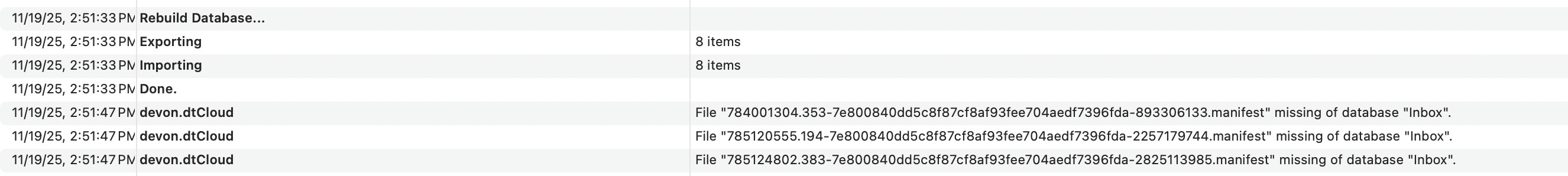

I deleted everything in the inbox, and emptied the trash and still get the log messages
I have tried all of these
Check File Integrity
Restore Backup…
Rebuild Database…

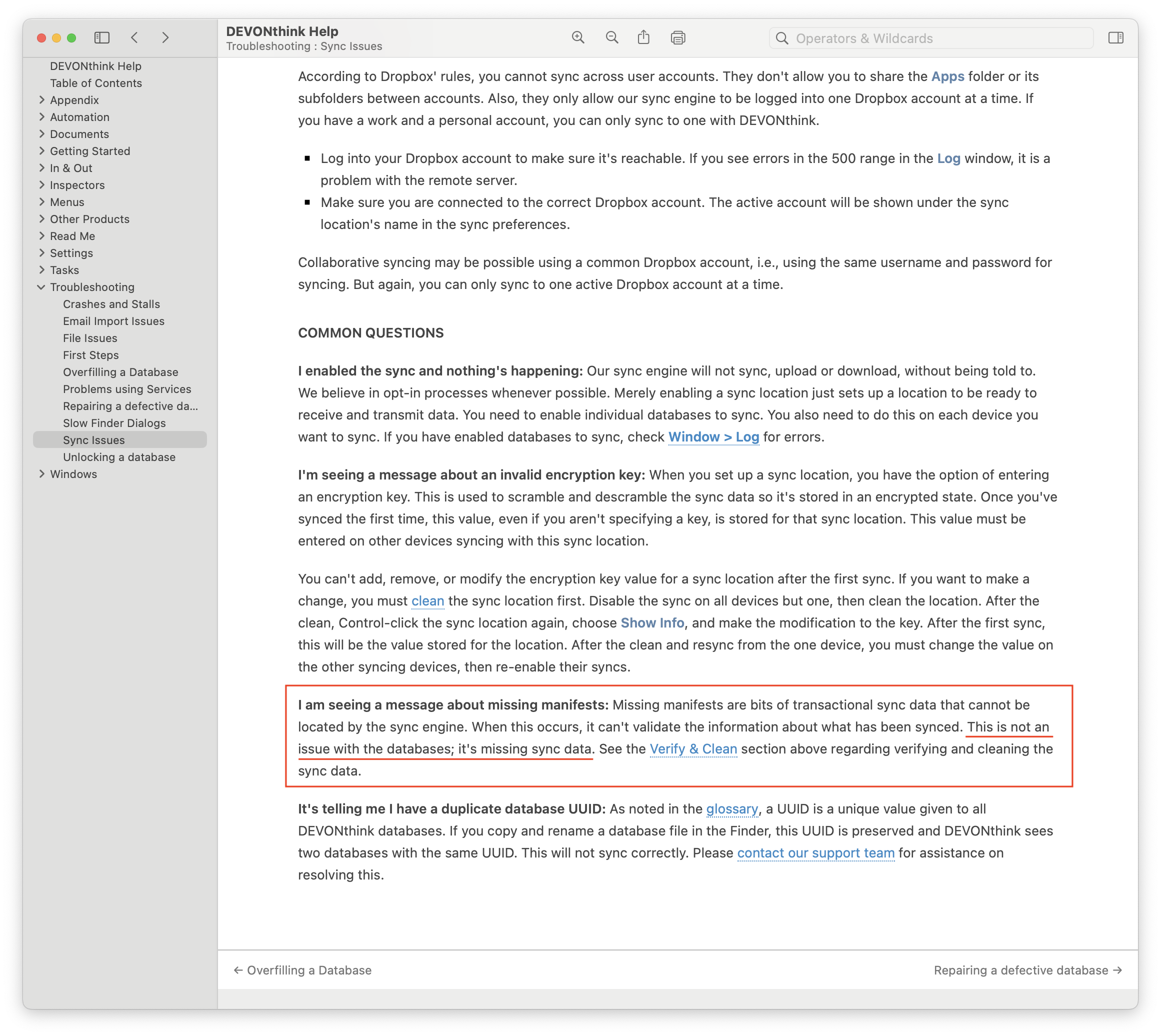

Have you tried verifying the sync location? (search this forum where this manifest symptom has been discussed).

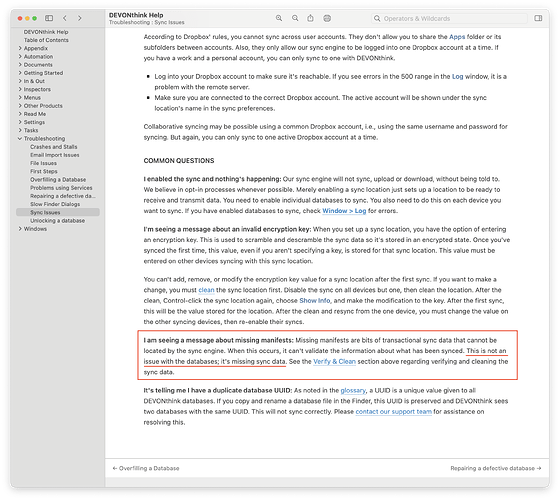

From DEVONthink Help:
I am seeing a message about missing manifests: Missing manifests are bits of transactional sync data that cannot be located by the sync engine. When this occurs, it can’t validate the information about what has been synced. This is not an issue with the databases; it’s missing sync data. See the [Verify & Clean](file:///Applications/DEVONthink.app/Contents/Resources/DEVONthink.help/Contents/Resources/pgs/troubleshooting-sync.html#verify) section above regarding verifying and cleaning the sync data.
