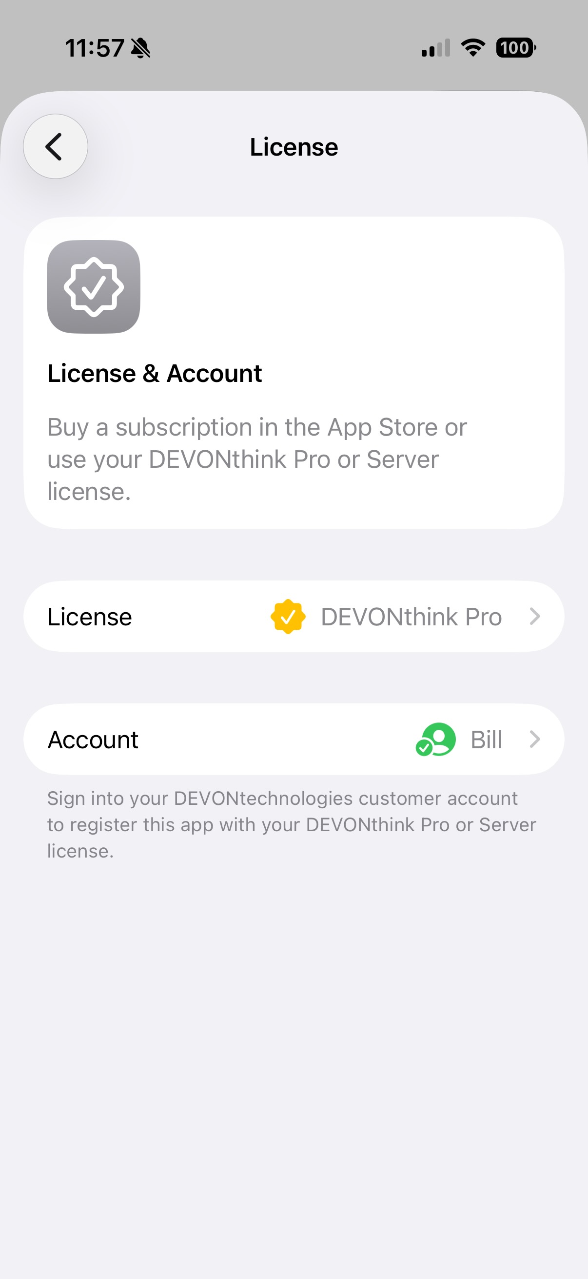

  1. I have extended my DT Pro subscription.
  2. I have installed the latest DTTG 4 from the App Store.
  3. I’ve logged in to DTTG on my iPhone, ensuring I have a License for DEVONthink Pro, and my Account = Bill

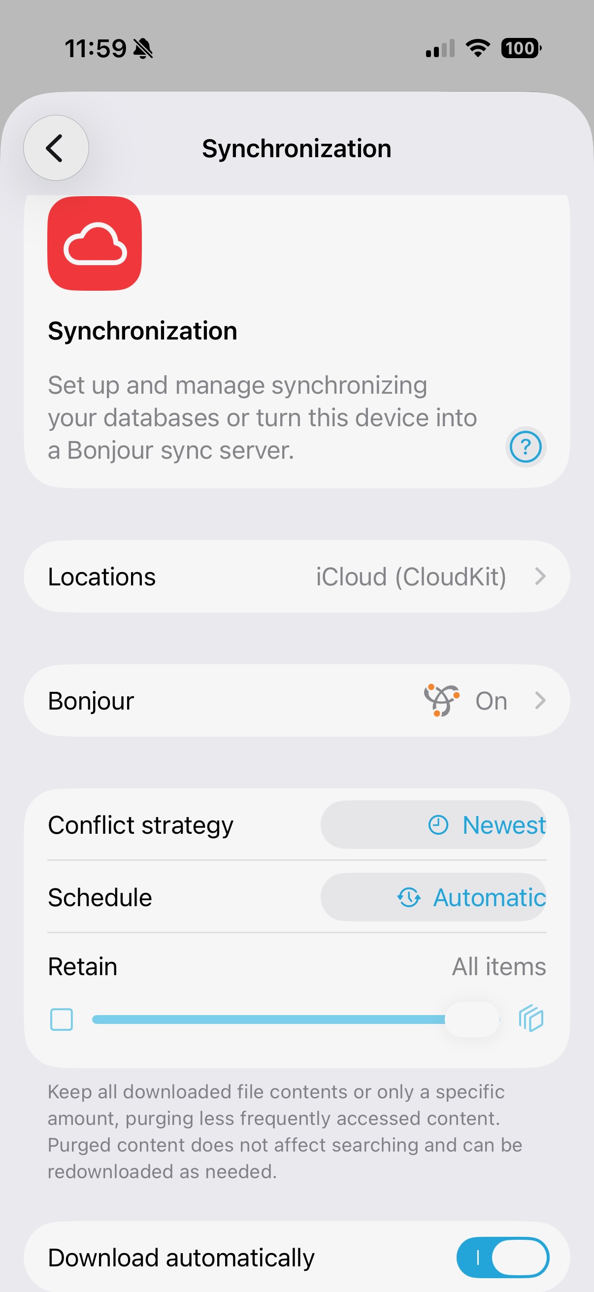

I have Synchronization turned on to iCloud and Bonjour:

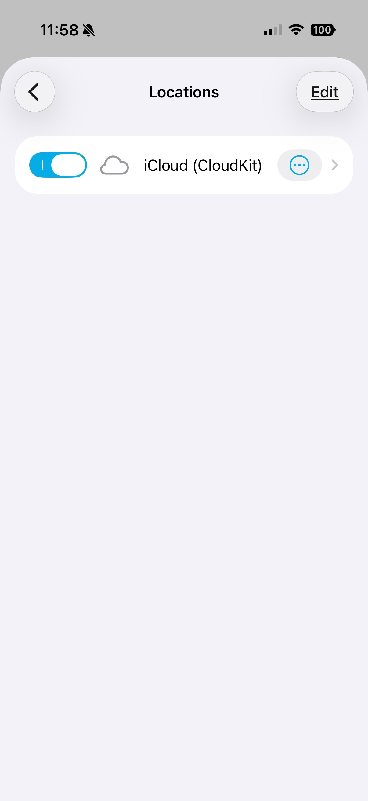

The iCloud sync looks like this:

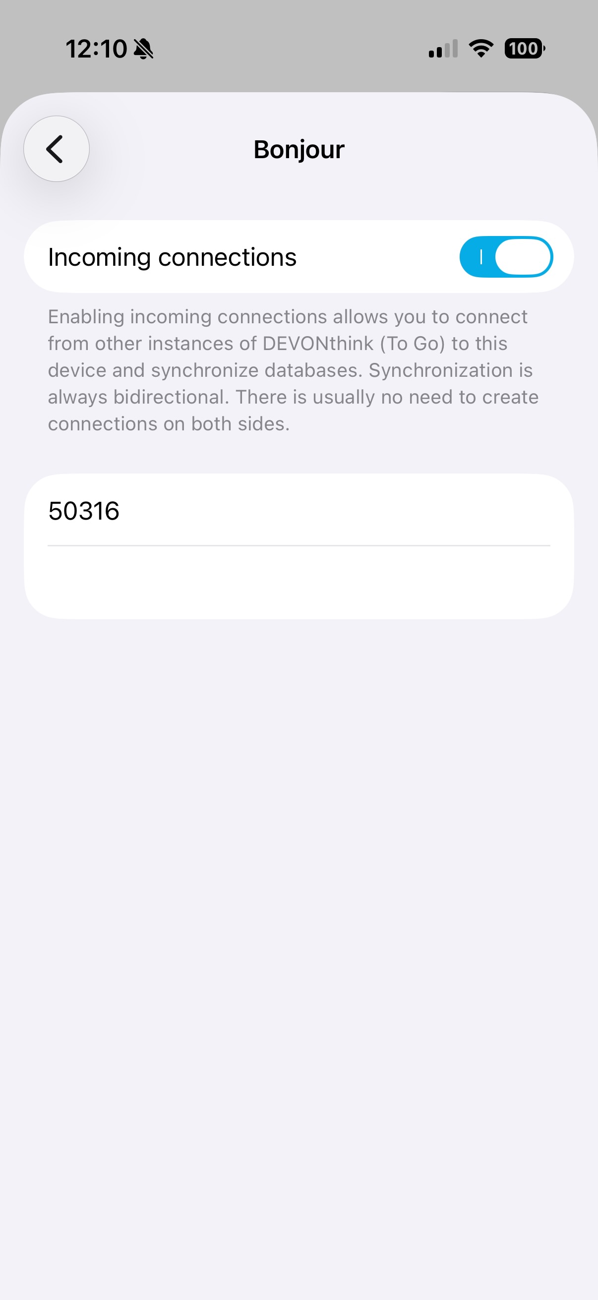

Bonjour looks like this:

I do not think “Incoming connections” with Bonjour should be on. Let me know
Perhaps you have not selected and databases to sync? What do you see when you click on the right pointing triangle in the iCloud sync settings?
And why do you use two sync methods?
@Ja_acov is correct you shouldn’t have Bonjour enabled unless this device was your Bonjour server. It also has no bearing on any other sync method.
And @chrillek is correct in asking about what you see when you tap the sync location.
D’oh! I had clicked the (i) but had not clicked the “>” to the right of it to select the databases.
Thanks Ja_acov!
