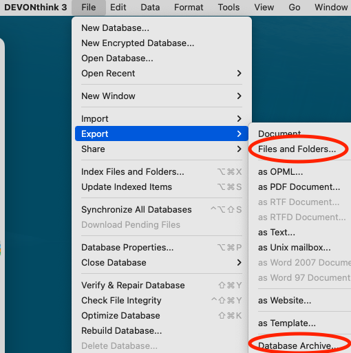

And could you let me know you have setup the manual backup to be stored in the cloud?
  • run weekly
  • two backups; database and folders/files

Thank you for the screenshot.
