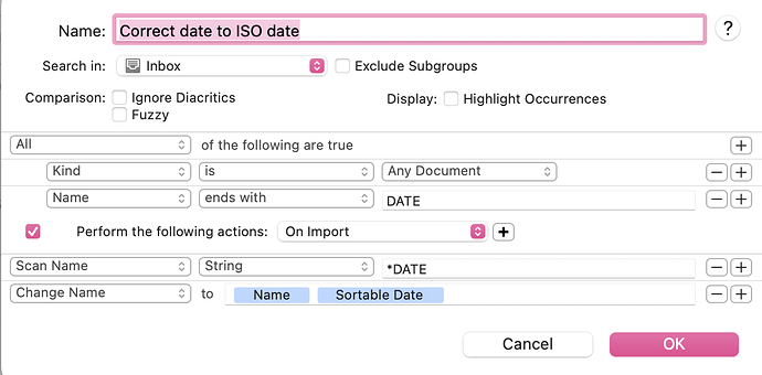

I have figured out how to use placeholders (yey), but I got stuck on one bit, please can you help? The smart rule runs when I write “DATE” at the end of a file name, but it doesn’t delete the word. So currently a file named Apples DATE then becomes Apples DATE2022-04-20. How do I tell DT to delete the word “DATE”? I thought scanning the string would identify the bit that needed changing but I am guessing the “name” placeholder is telling Devon to put the whole name back in? This is my smart rule:
If it’s simple can you explain which bit I did wrong so I understand for next time.

Yes the norm is for search and operations like the one shown here to be case-insensitive.
Use * DATE, noting the space between the two, in the Scan Name action.
And instead of the Name placeholder, insert the Document String placeholder.
Ahhh I missed the “document string” placeholder. Now corrected and it’s working perfectly, I’ve also added the space you recommended so the rule doesn’t run in error.

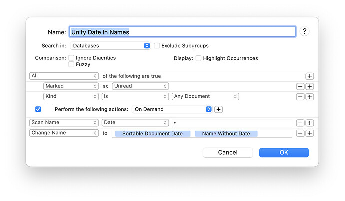

The next release will add a new placeholder and a new default smart rule to simplify this (and a Scan Name > Date > * action isn’t supported currently either):
