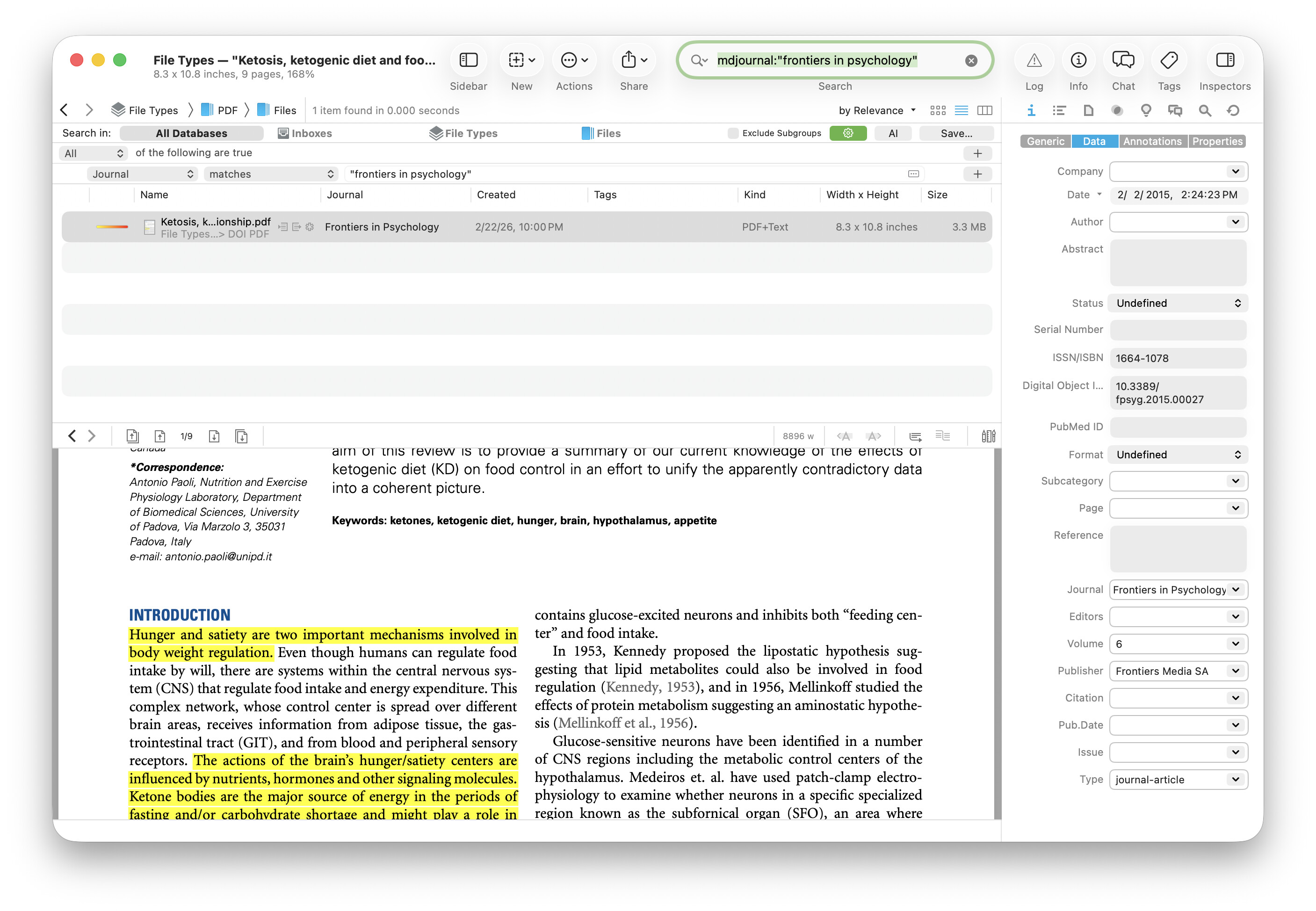

  • Using custom metadata, you can also search for specific things. If you use the Download Bibliographic Metadata smart rule, available information is populated in custom metadata in the Info > Data inspector. So you could search for something like mdjournal:nature climate. Here is an example showing the Data inspector, the raw and advanced search queries, and a matching document with the custom metadata field as a List view column…

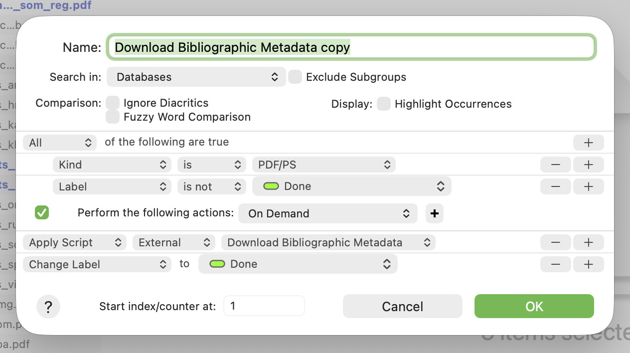

You can duplicate this smart rule and add a filtering criterion and an action to apply the attribute. For example, I added Label is not Done as a criterion then the Change Label action to add the Done label. This way the documents won’t be matched after they’re run through the smart rule.

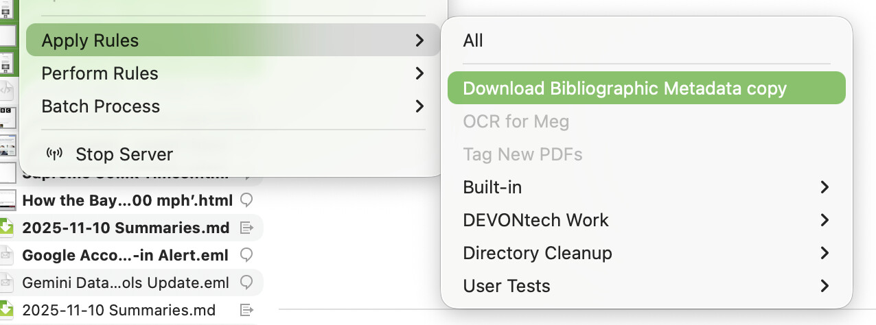

Now you can grab a handful and either drag and drop them on the smart rule or use Tools > Apply Rules and choose your copied smart rule, e.g.,…

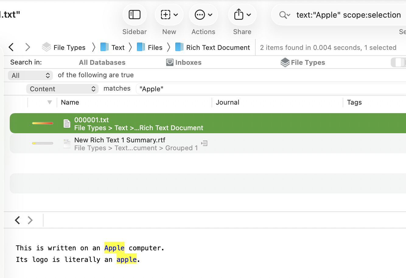

Correct. The index doesn’t distinguish case, so toolbar searches ignore it, even when the term is quoted.
Also, the toolbar search doesn’t support regex.

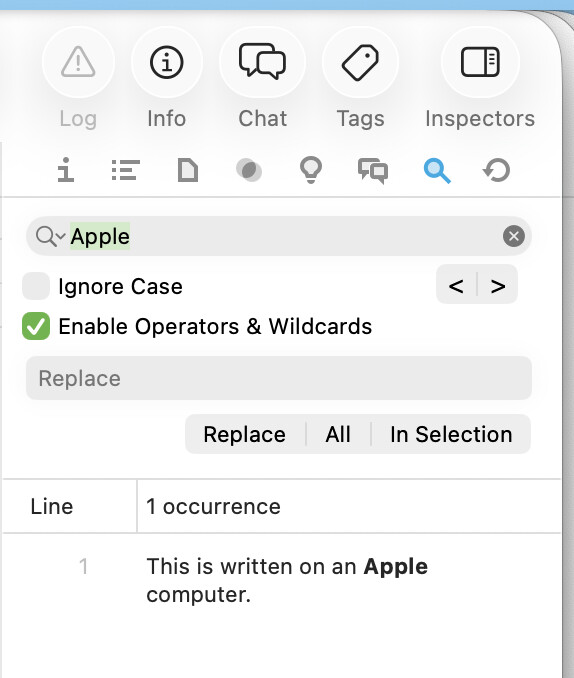

However, in-document searches via the Search inspector do allow for case-sensitive searching…
