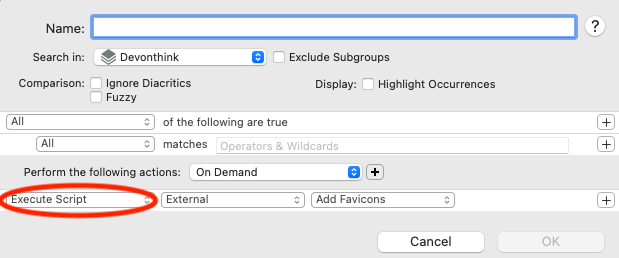

As I already said:
If you have a smart rule, the script can be triggered as an action
Screen Shot 2021-11-10 at 13.33.48
My example above retrieved selected records using “set theSelection to get selection”
Here’s sample code to retrieve the records from the smart rule
end performSmartRule
