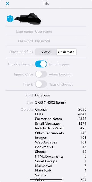

I have tried to set a sync location to On Demand and then set one of the databases to sync Always but I can’t get DTTG to accept the change. When I click on the i icon on the database, it shows sync as On Demand. This doesn’t change when I click on Always - it appears to be locked on the On Demand setting.
Is there something else I need to do so that I can have one of the databases in a sync location syncing On Demand and the other syncing Always?

Are you syncing the database with more than one sync location, e.g., Bonjour and Dropbox?
No, just WebDav on a NAS. However, although Bonjour is set to Off its sync method was Always. I’ve changed that to On Demand and now I have successfully set one of the databases’s sync method to to Always, contrary to the advice from @chrillek.
Thank you for your very helpful advice.
Were you previously using a Bonjour sync, perhaps for the initial import?
Yes, that’s correct.
And then you disabled the Bonjour sync location later?
Bonjour sync location was disabled all the time I was trying to set one of the databases to On Demand. Then, when you asked about syncing with more than one location, I changed the Bonjour location from Always to On Demand. After that, I was able to change the file download setting for either of the databases from On Demand to Always. The Bonjour location remained disabled all the time. Strangely, only one of the databases has previously been synced using Bonjour, but both of them were affected.
