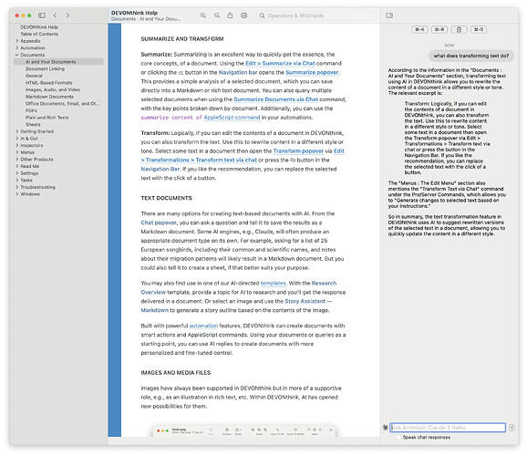

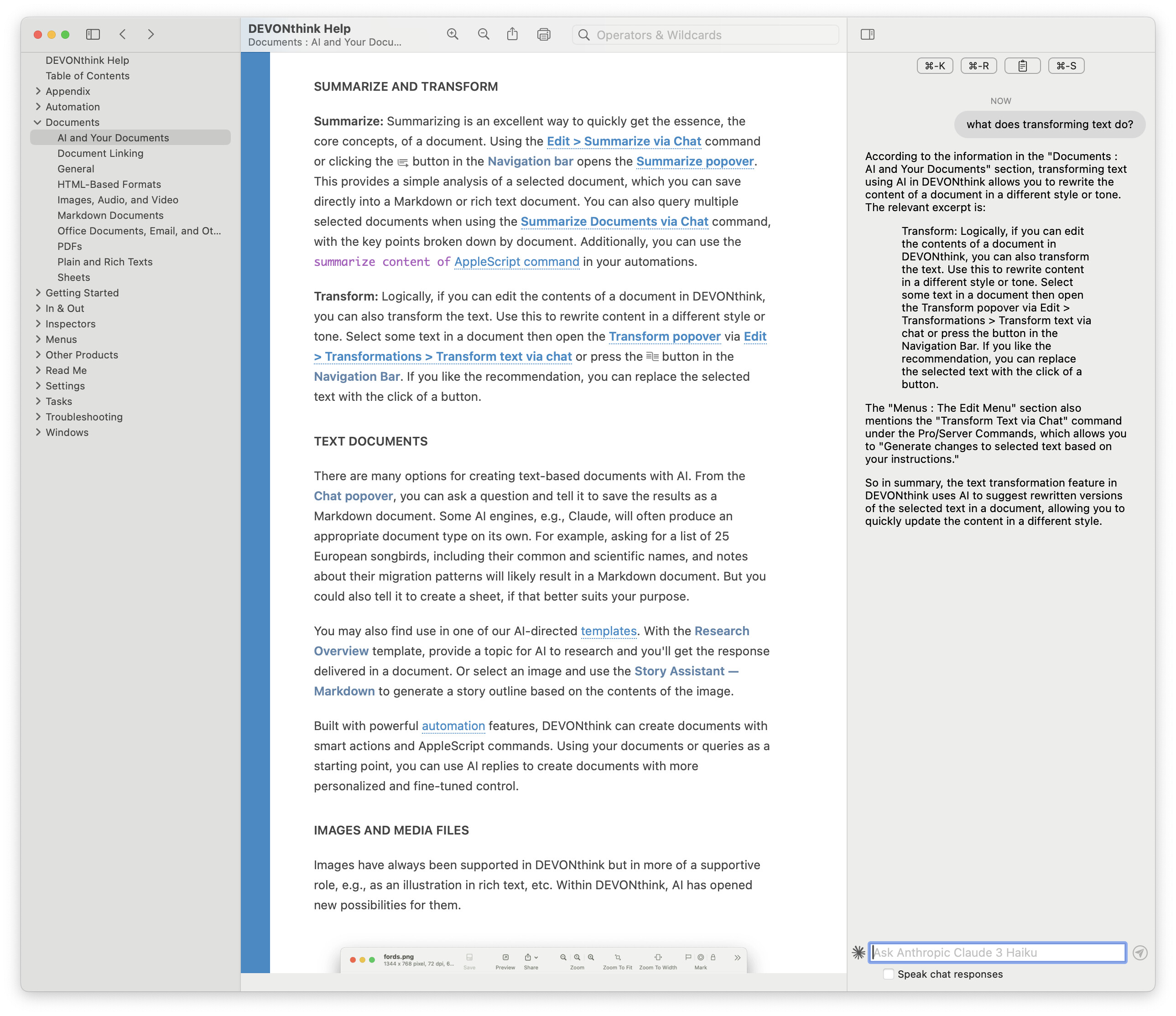

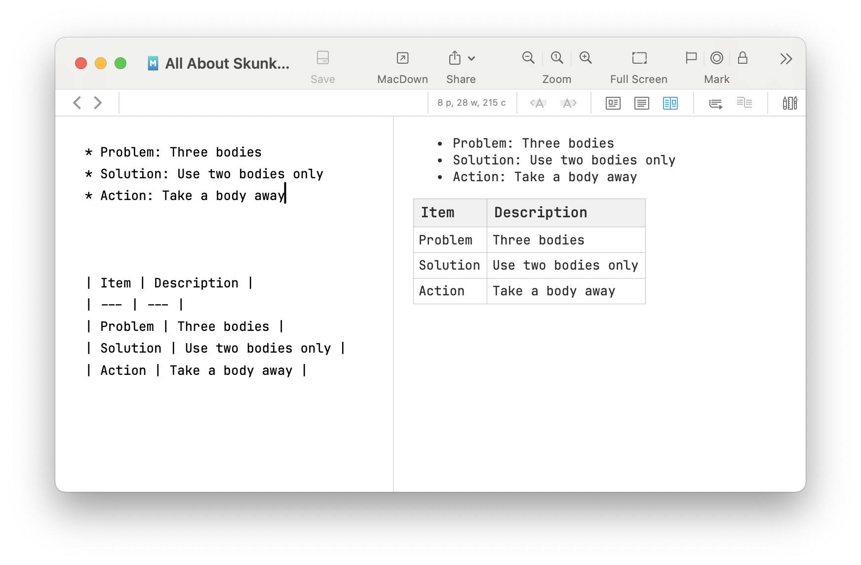

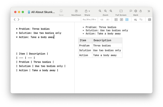

Why are you trying text transformations versus a prompt?
Sent to GPT 5 (Mini) via the Chat assistant
convert this text into a Markdown table and append it to the document's text.
PS: The documentation states what transformation does so there’s no reason to guess or overthink these things.
You can even ask the Help Assistant about it…

Interesting that the Chat assistant can do this! Thanks for this. Will for sure try this out!
