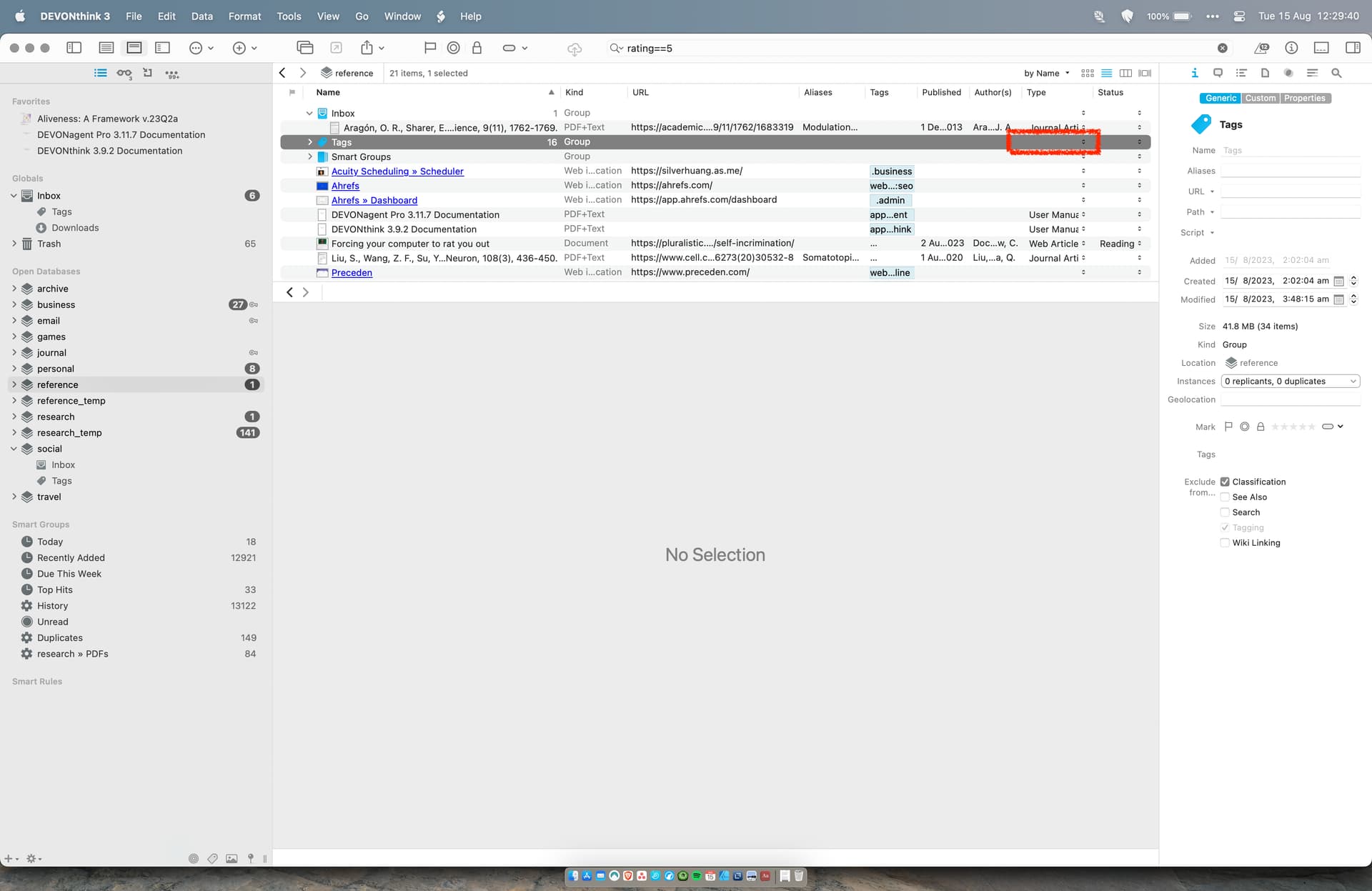

I know this is a super old topic, but as someone who has zero knowledge of scripting (and doesn’t dare to touch scripting yet, in case I break something and mess up my databases), I stumbled into the same difficulty yesterday, and figured out a way around it without scripts that I hope may help someone else in the future.
So I accidentally clicked a Metadata Set field and selected an option that I didn’t want and was unable to unselect it.

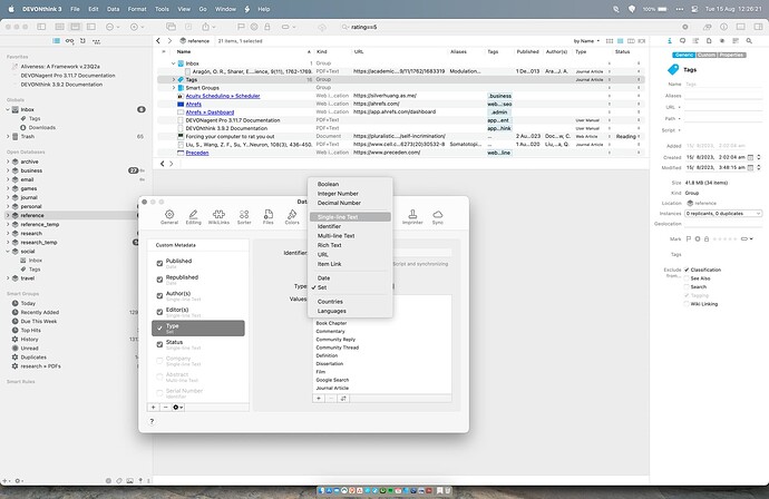

I found this topic in my search for a solution but didn’t feel like wrangling with scripts just yet. So I went into Settings > Data to see what I could do, and discovered that I could change my Metadata Type from Set to back to Single-line Text.

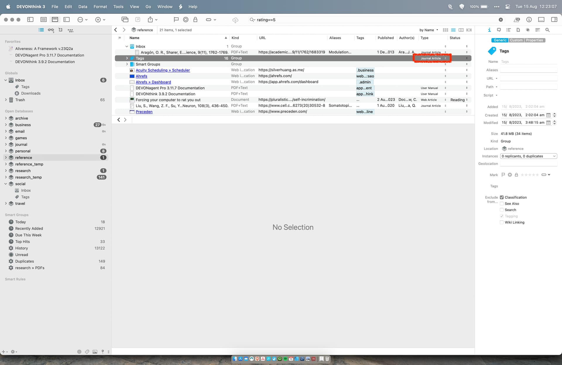

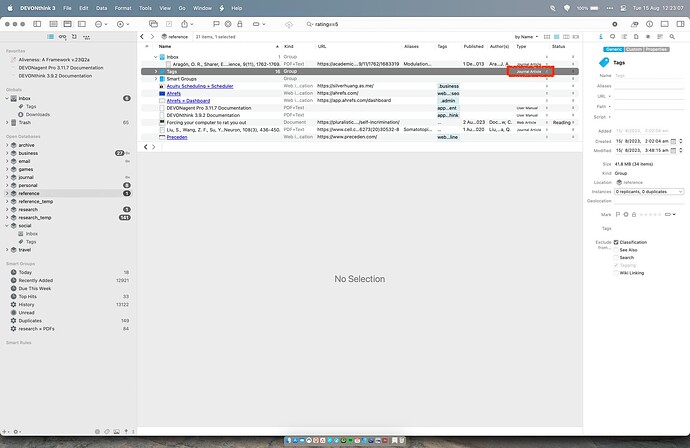

Once I’d done that, what happens then is I can go back to the field in DEVONthink, and when I click on it now, instead of just giving me the fixed options of a Set, I can select the text and delete it.
Now I can go ahead and change my Metadata Type back to Set if I wish, but for me, I’ll be sticking to
Single-line Text from now on, as I realised that, for my needs at least, it does the same thing as Set but I don’t need to worry about clicking the wrong thing now and having to switch back and forth to fix it.
