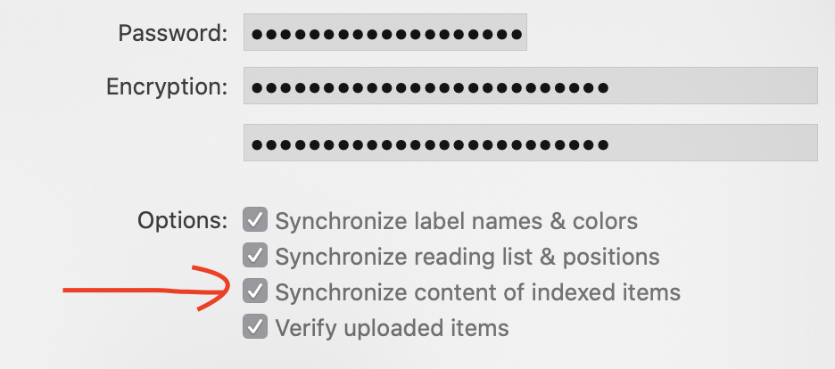

Sorry if I say a stupid thing, but do you have indexed items and this thing enabled in your sync database?:
If yes, you are uploading the database and the indexed files.
(Capture is from macOS Devonthink -> Preferences -> Sync)
