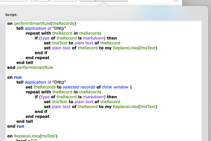

I’m aware of existing solutions available elsewhere. As a coding exercise I wrote the following simple script to convert reference-style links to inline ones. Tested successfully on 2 news clippings.
			if (type of theRecord is markdown) then
				set thisText to plain text of theRecord
				set plain text of theRecord to my ReplaceLinks(thisText)
end performSmartRule
on run
		set theRecords to selected records of think window 1
end run
on ReplaceLinks(theText)
	local pTID
	set pTID to AppleScript's text item delimiters
	set paragraphList to (paragraphs of theText)
	set fnFlag to false
	repeat with i from 1 to (length of paragraphList)
		set tp to item i of paragraphList
		if tp begins with "[1]:" then
			set fnFlag to true
			set AppleScript's text item delimiters to linefeed
			set mainText to (paragraphs 1 thru (i - 1) of theText) as text
		if (fnFlag is true) and (tp begins with "[") then
			set AppleScript's text item delimiters to ": "
			set theLabel to text item 1 of tp
			set theURL to "(" & (text item 2 of tp) & ")"
			set mainText to my ReplaceText(mainText, theLabel, theURL)
	set AppleScript's text item delimiters to pTID
	return mainText
end ReplaceLinks
on ReplaceText(theText, searchStr, replaceStr)
	local prevTID
	set prevTID to AppleScript's text item delimiters
	set AppleScript's text item delimiters to searchStr
	set theItemList to text items of theText
	set AppleScript's text item delimiters to replaceStr
	set theText to theItemList as string
	set AppleScript's text item delimiters to prevTID
	return theText
end ReplaceText

Thanks @meowky, this is how i set it up. Is it correct.
I will not be able to test until later Sunday.
This is how I set it up.
I won’t be able to test until Sunday. Thanks
