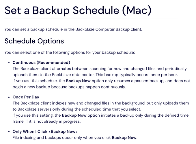

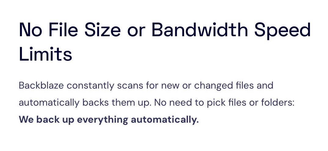

Well, this is concerning from BackBlaze’s site…
It has been discussed very often (including in the documentation - Getting Started > A Word About Backups), you shouldn’t use a continuous, or real-time backup. You should use a scheduled snapshot-style backup similar to what Time Machine uses.
It also looks like the only scheduled backups they now support are once a day (which should actually be sufficient in many cases)
