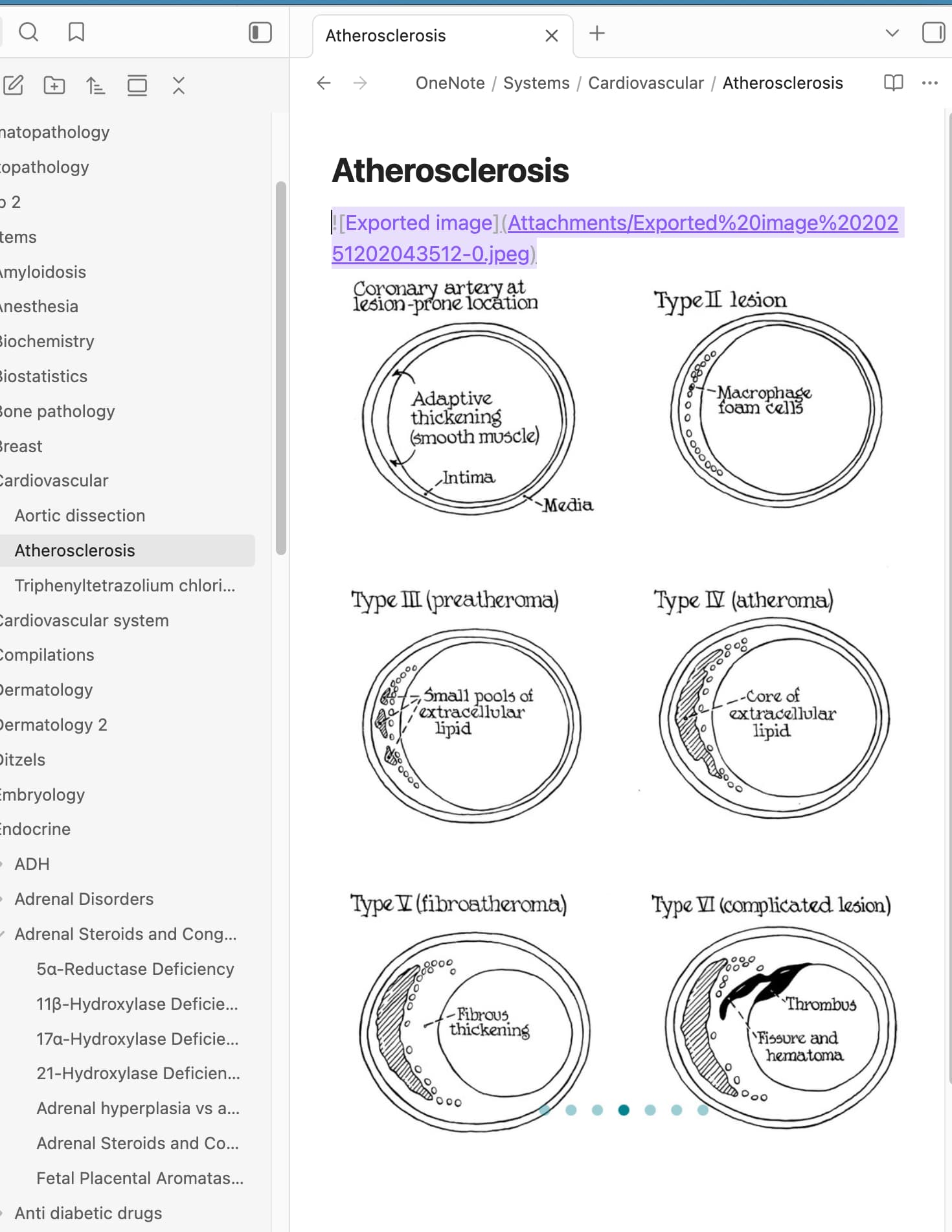

So I have tried importing my notes from onenote to obsidian using “importer” plugin. I can see the notes in obsidian but the same note doesn’t display the image on dt4 , I think it’s because the image isn’t linked in wiki link [[ ]] , it is in ![ ]() format , how do I convert all the image links from this to [[ ]] so that it can be displayed on dt4.
![]() is the correct MD format to refer to images. There’s nothing between ] and (. Why would a wiki link be needed to display an image?

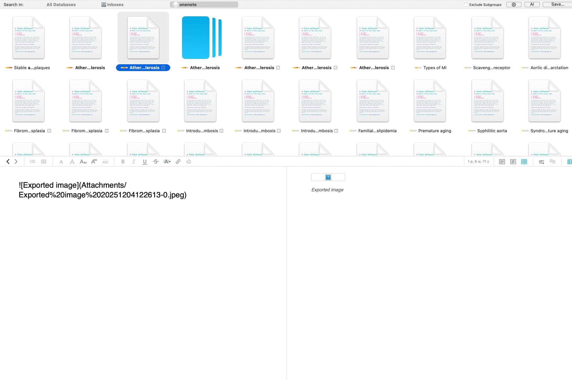

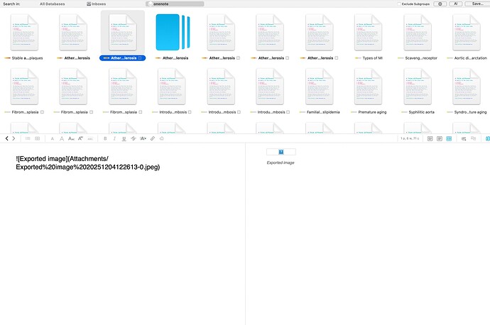

this is the same note after importing into dt4
The image(s) must be in a sub-group named Attachments. And no, this has nothing to do with DT. It is just how links work.

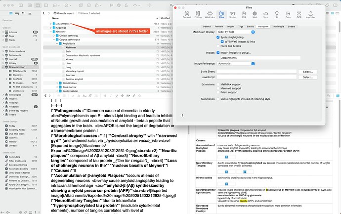

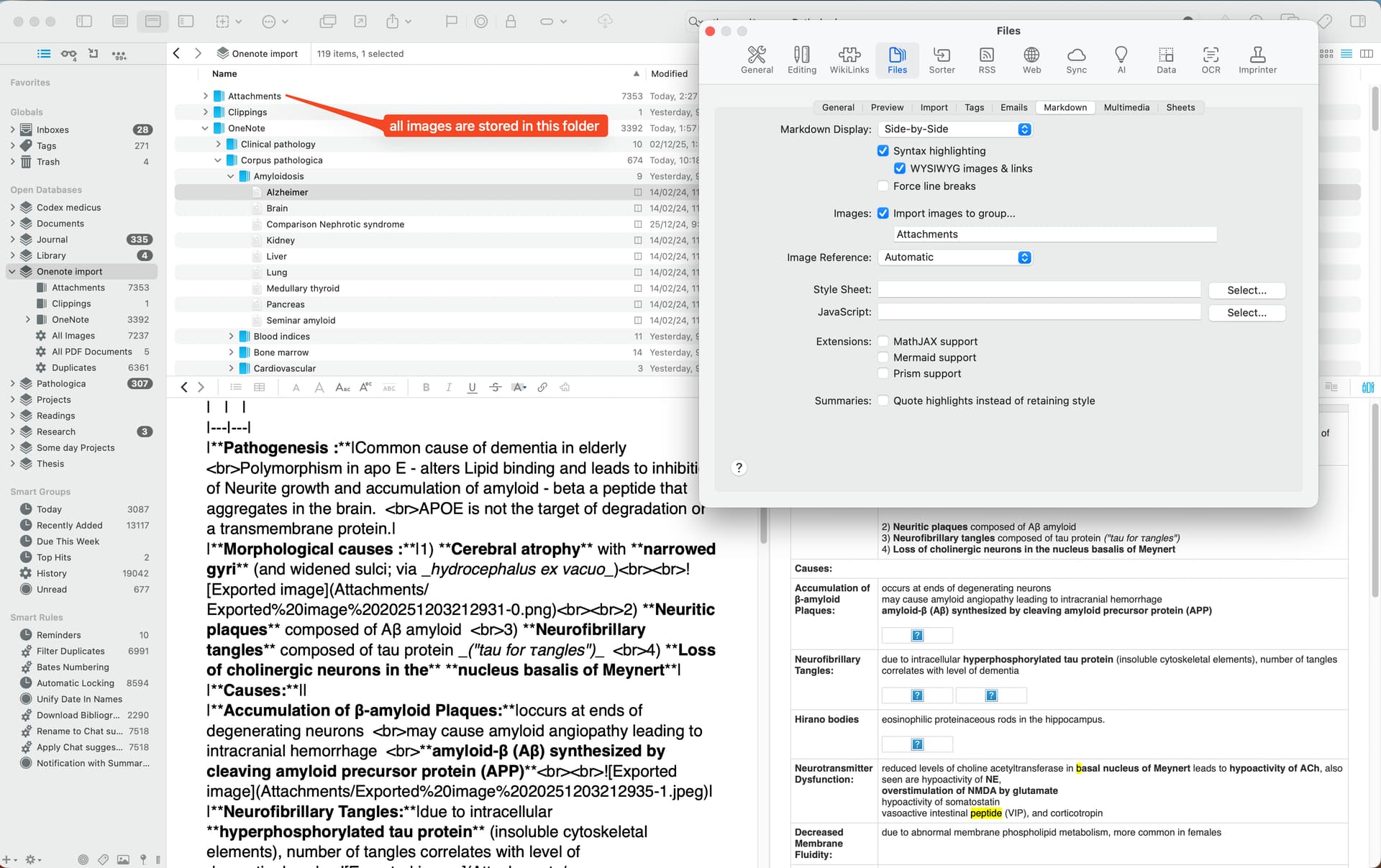

I have imported the attachments folder into the database also.

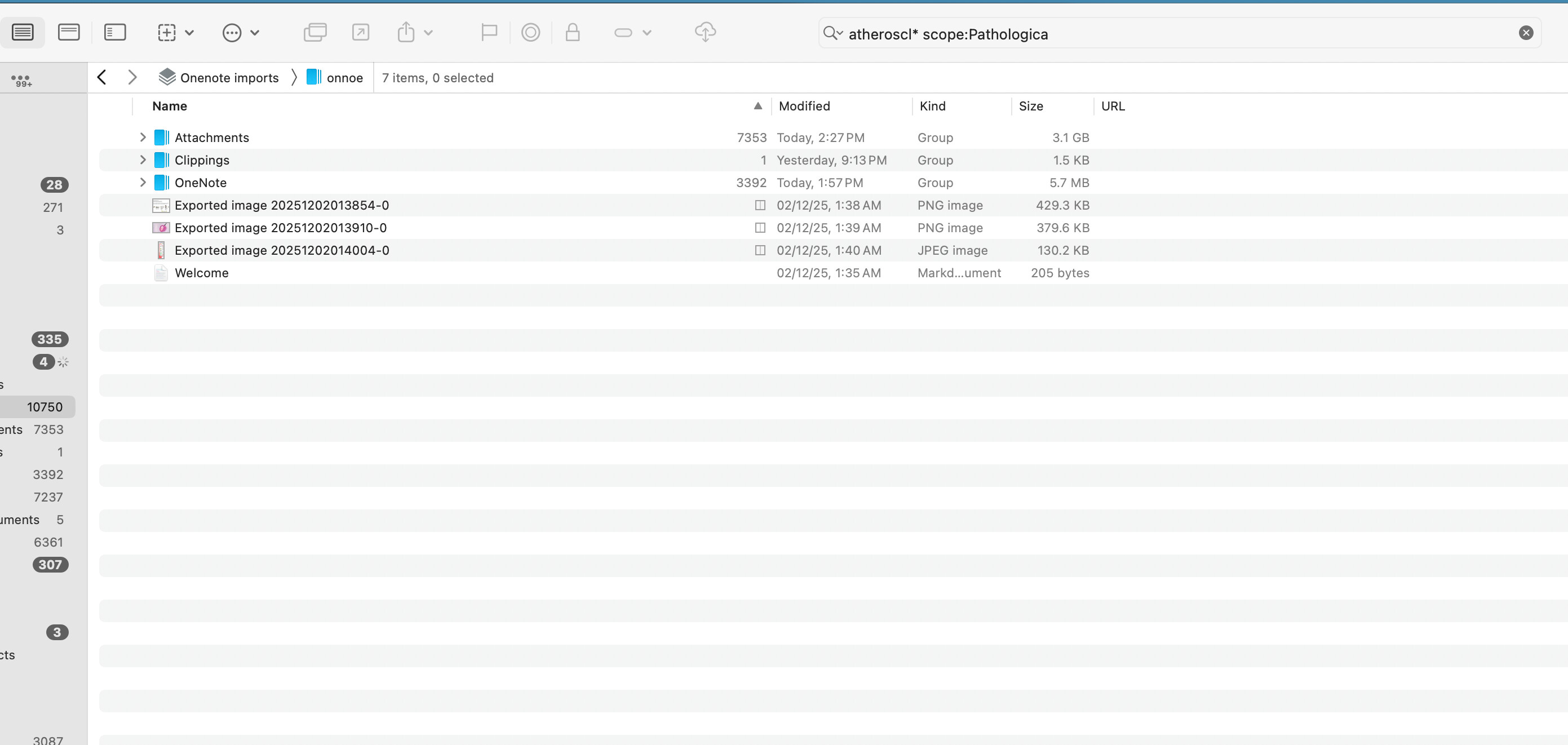

A screenshot showing where in the database your document and the attachment group are located, would be helpful.
I have also toggled “Attachment” on and then imported the obsidian vault into a new database in dt4

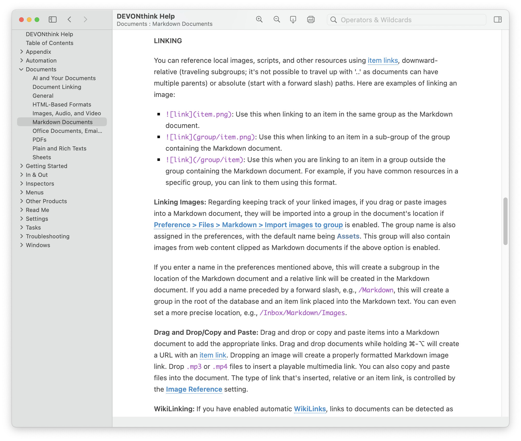

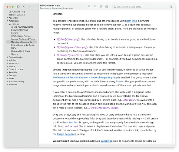

Your path is wrong. Yours is pointing at a subgroup in the parent group of the document, as discussed in the Documents > Markdown Documents > Linking section of the built-in Help and manual
So yours would be e.g., ![my Image](/Attachments/percent%20encoded%20name.jpg).
I don’t know how to change all the links in bulks, have more than 1500 notes. so I put all the notes and images without folders/groups directly in the database. Its showing up the images now but my organization is messed up.
