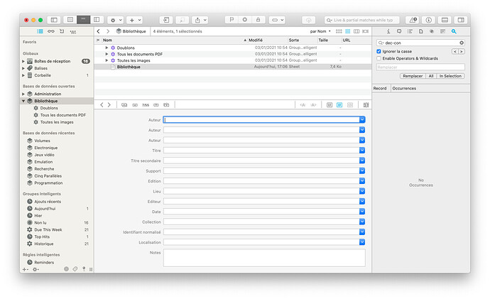

This is what my sheets looks like. The name is “Bibliothèque” and you can see the table view in the bottom panel, with records fixed.

Thanks very much for the detailed instructions; I can confirm the behaviour you are describing; Jim’s response and my quick experiment would suggest that the identical column names are responsible. I guess the quick workaround would be for you to rename the columns “Auteur un”, “Auteur deux”, “Auteur trois” or some such.
Still sounds like a bug to me, though - i.e. if providing the columns with identical names leads to interactions such as these, then I think I would expect DT to inhibit you from doing so. It’s not uncommon though - if you’ve ever designed forms in Acrobat or similar and used any for of duplication, you might well have been in for a surprise when you thought you had finished. Not that I’m blaming Adobe for that - after the fact it’s all pretty obvious…
