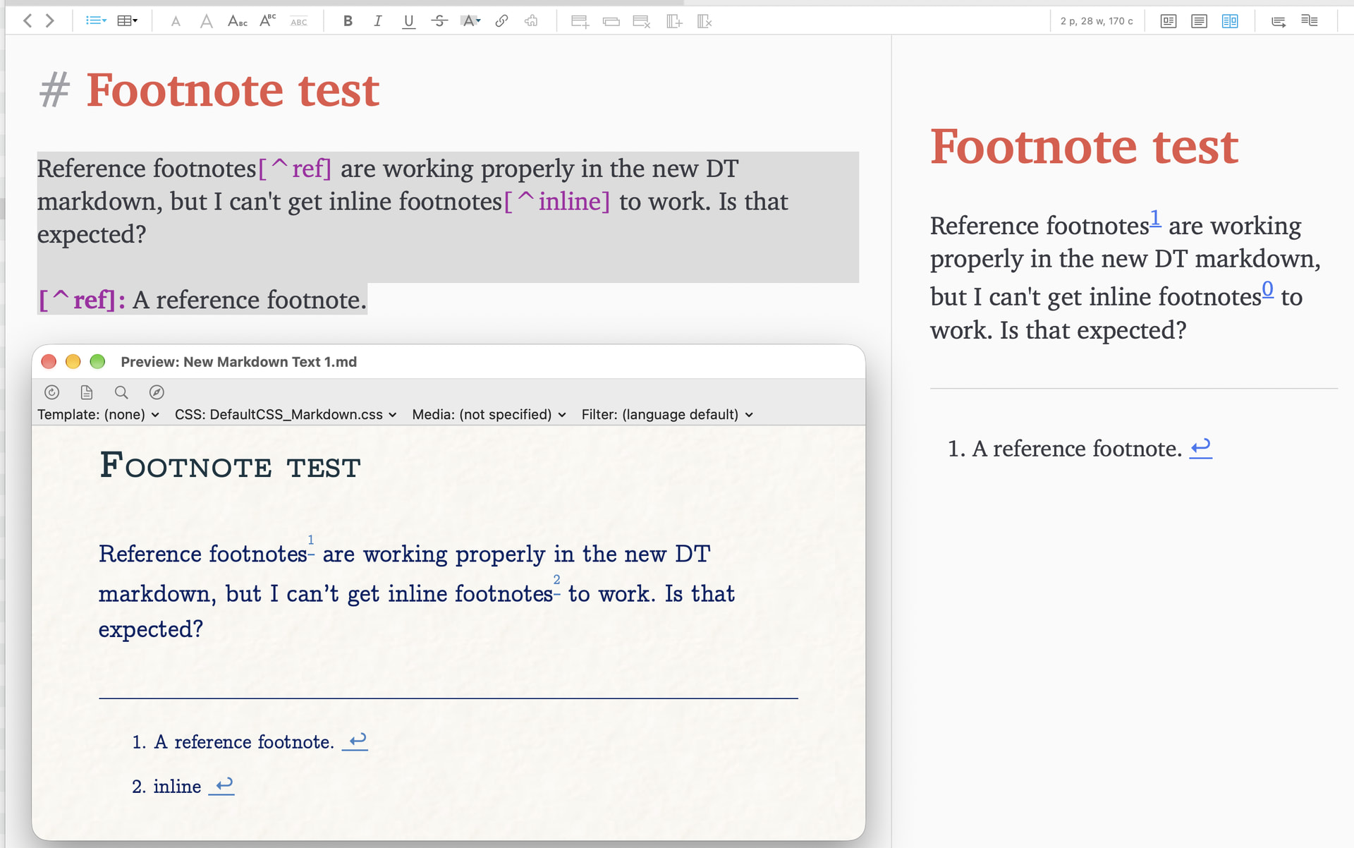

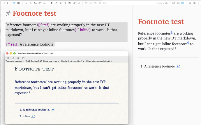

I can’t get inline footnotes to work in DT 4.4.1 on Golden Gate 27.0.1.
Please see the screenshot below. The inset preview is of the same file in BBEdit, where the inline footnote does work.
The Help suggests that this should work, so is this a bug, or am I doing something wrong?
Thanks!
Just adding a space after inline and it will show up
@gul-iMac is right:
Thanks for the quick replies, @cgrunenberg and @gul-iMac!
That’s a bit of a shame because other editors (and Marked) do accept single-word inline footnotes (see the BBEdit preview in my screenshot) and I’ve never had to think about it before. Is this new behaviour with the (excellent) DT Markdown parser – I don’t recall it being a problem in earlier versions?
In any case, please could I ask for single-word inline footnotes to be catered for in a future version? (It’s a relatively minor point, I know, but it would be useful for compatibility with other editors.)
Thanks!

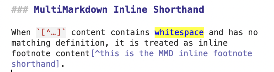

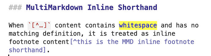

JFTR: Markdown Footnotes: Syntax and Platform Guide - Markdown Editor Online
Thank you for the link. The issue seems to be that the reference (or Fletcher Penney’s own documentation) doesn’t define what to do with a single word inline reference – you’ll note that all their examples are for multiple words, which is not the same thing as requiring a space for a single word…
Marked, BBEdit, IA Writer, and others do allow the single word note, and until the recent introduction of DT’s own Markdown, so did DT (as far as I remember…). I have over 16,000 markdown documents in DT, and an unknown proportion of those have single word footnotes… and I can’t think of a way in DT to find out which ones!
But leaving that aside, not needing the space seems to me to be a more flexible solution, given that it’s so widely used elsewhere, and a change wouldn’t break notes that do include the space. So if it can be incorporated into an update at some point, that would be great.

The next release will support this
