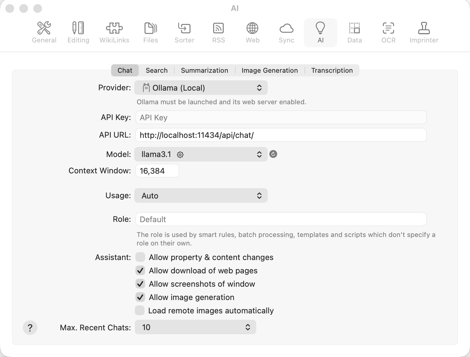

I successfully installed Ollama with llama3.1 as the local model. Devonthink 4.2.2 sees it in settings

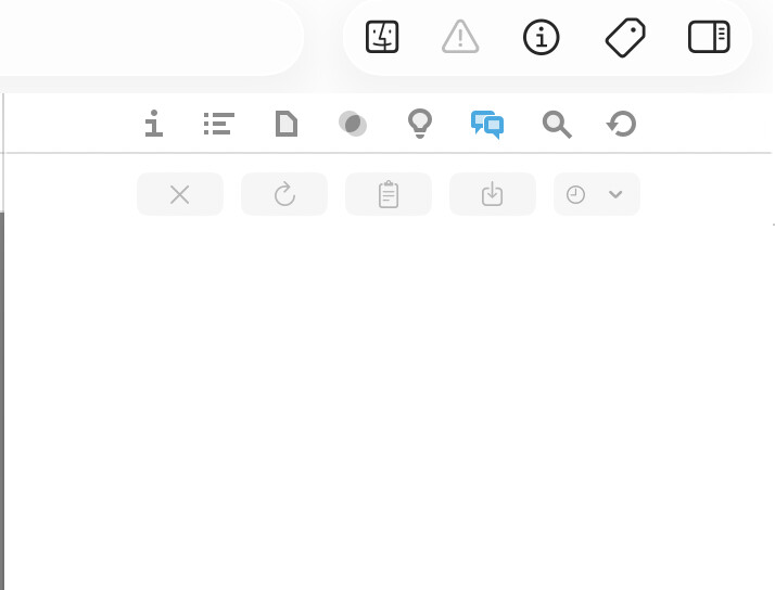

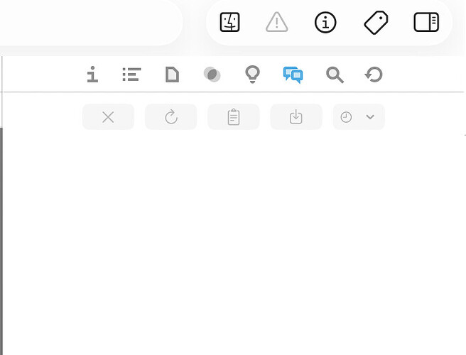

However, when I go to the chat inspector with a document open all of the buttons are greyed out.

There is no need to run any Terminal commands (outside of downloading some specific models with ollama pull…).
When the Ollama app launches, its webserver automatically runs on localhost. Ollama’s setting to be exposed to the network is for connecting other devices.
All what buttons are grayed out?
Upper right part of my screen (with a document open)
There is no conversation to: clear, resend, copy, or save and no recent chats to choose from. Those buttons are only enabled if you’ve got a chat going. So it’s behaving as expected.
