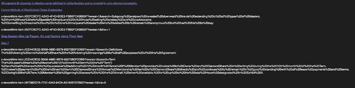

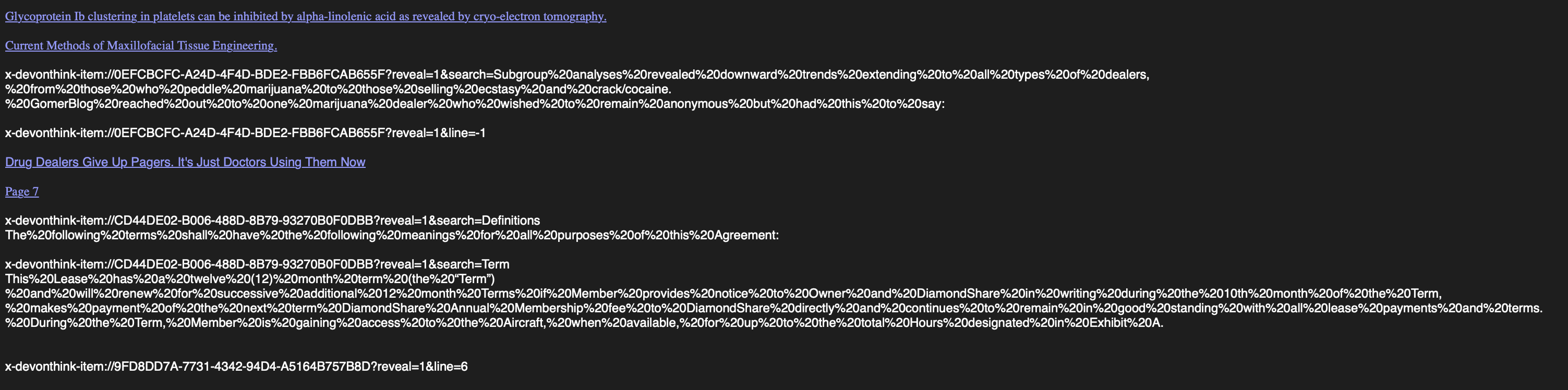

Question - is it possible for me to tweak this so that the resulting link is an active hyperlink with a relevant name (such as the backlink examples below in color) rather than non-active links (such as the white examples currently generated by the script):
I don’t think so… but I’m no expert.
Should be easy to do. ~Line 6:
set link_text to find_text
(To save the copied text as something to use later.)
Then, when the URL is copied to the clipboard, instead do:
set the clipboard to “[“ & link_text & “](“ & itemURL & “)”
Of course, that’s for markdown. Pasting an RTF formatted link might be a bit trickier but the same idea should apply.
(I haven’t tested that code, so apologies if it fails immediately!)
Yeah, it’s pretty easy for a markdown link since it is raw text. But I tried doing this for RTF before, and it gets (sigh) complicated…
