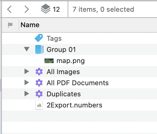

records contains any item at the top level including documents.
As Criss noted, records returns only top-level items.
As seen here, this includes: Inbox, Trash, Tags group, smart groups, groups, and and documents (here, the 2Export Numbers file)…
You’ll notice the map.png file isn’t reported as it’s a child of the group (parent) Group 01.
Also note the Inbox is reported though it’s not shown when using Unify inboxes and the Trash is also reported as they’re both top level items.
