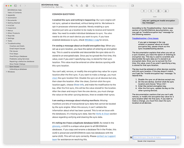

This topic is documented in the Troubleshooting > Sync Issues > Common Questions section of the built-in Help and manual. And if you have external AI access set up, you can use the Help Assistant to ask about it…
Since you’ve changed lots of settings and we’re not sure what the error was or how you might have made it worse, I personally would be a big fan of deleting any current sync store, disabling all sync, and starting from scratch while following the manual. That should fix whatever issue you’re having!

I hope you noted in the documentation, this cannot be done retroactively. You will need to clean the sync data, modify the key’s value, then resync the desired databases again.
