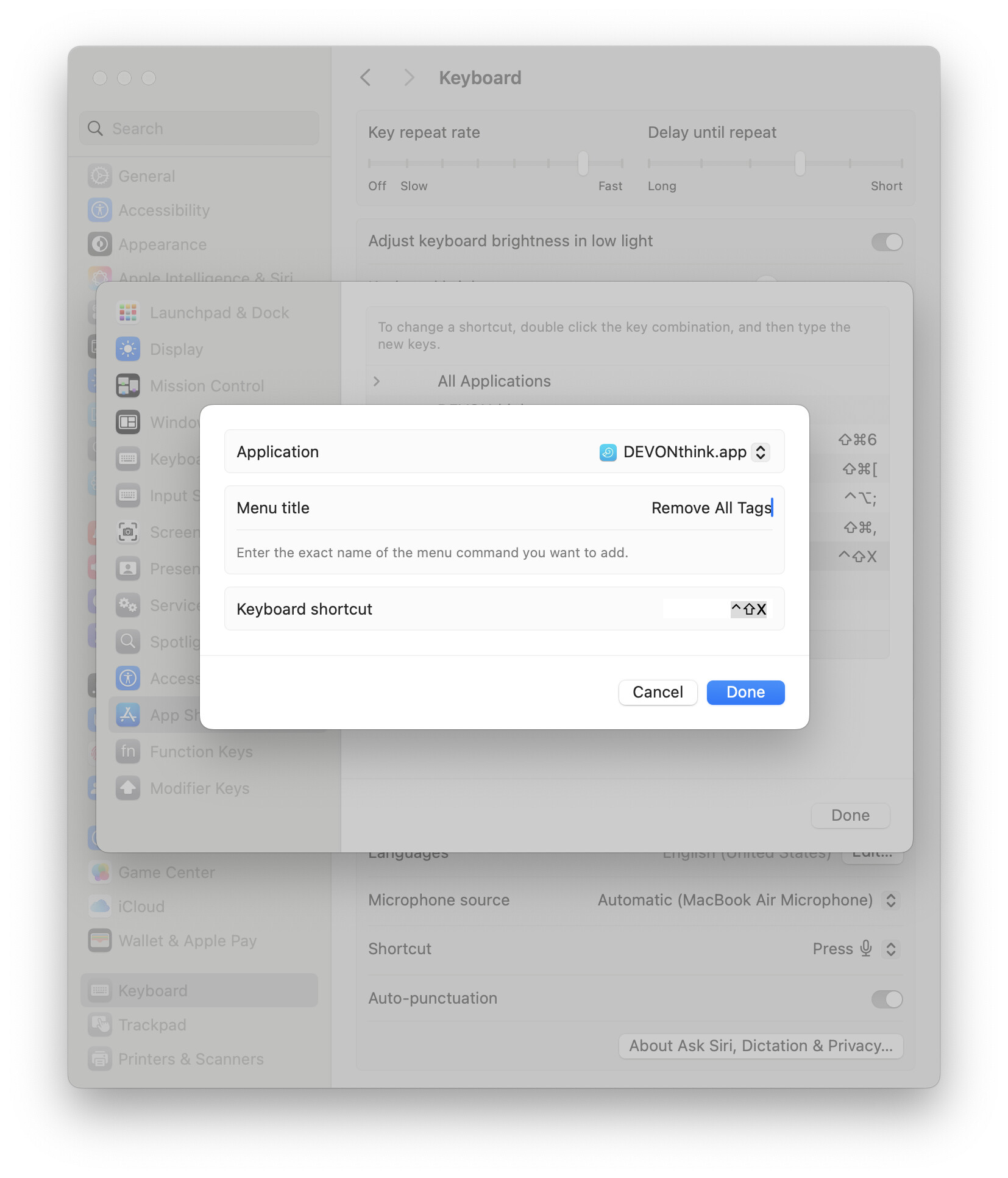

KM isn’t needed for this at all ![]()
Just assign a custom hotkey in System Settings > Keyboard > App Shortcuts…

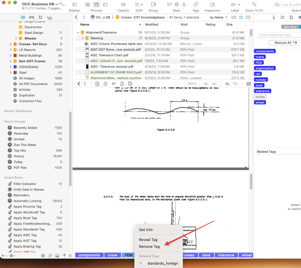

I apologize for having composed such a terribly worded question. Let me try again.
Maybe a couple pictures would help.

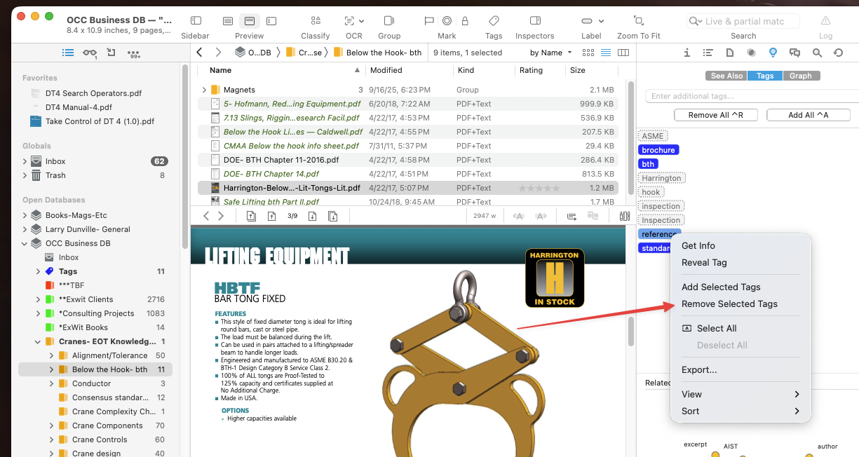

I want to assign a keystroke to “remove selected tag”. I could then assign the keystroke to a Stream Deck button, which would make the curation of my files much, much faster than the current multiple mouse clicks.

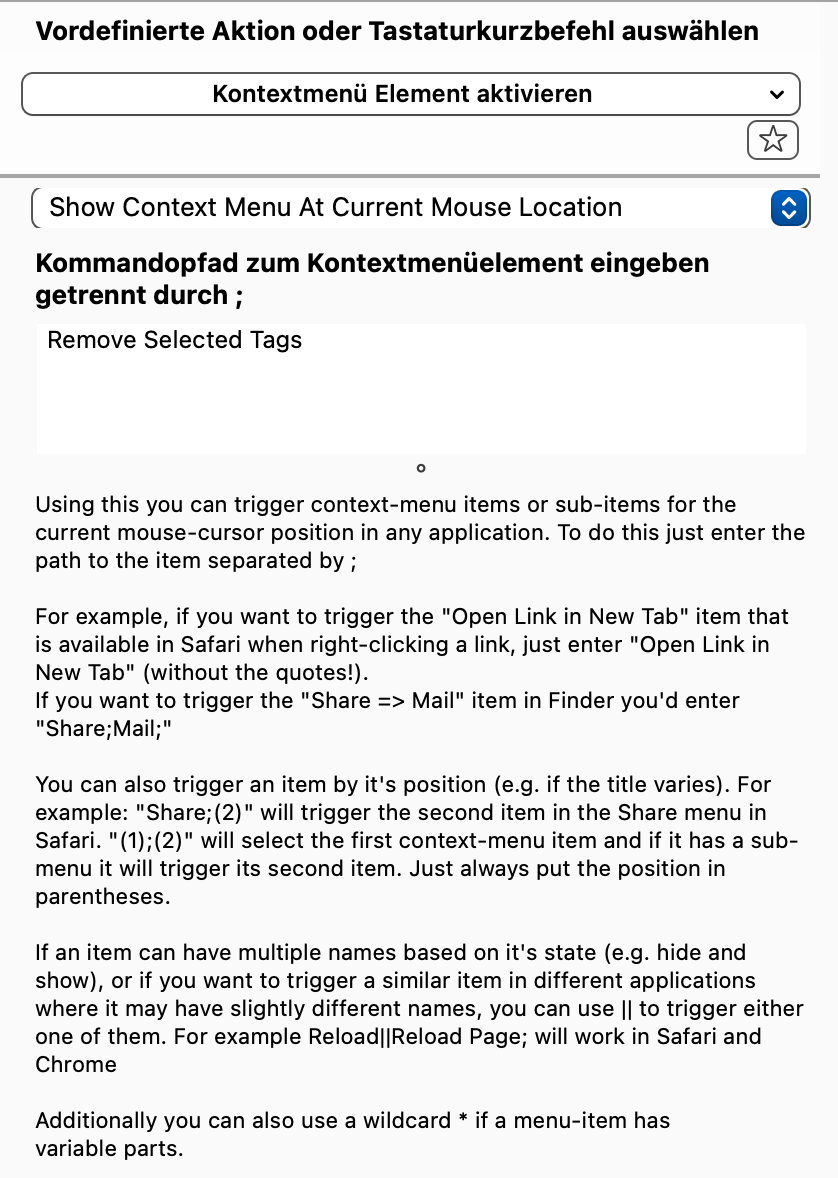

Not sure if I understand correctly. You want to select something specific from a context menu? That seems a bit awkward to me… but since you mentioned BTT … how to do it is explained in the text.

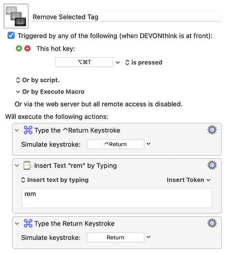

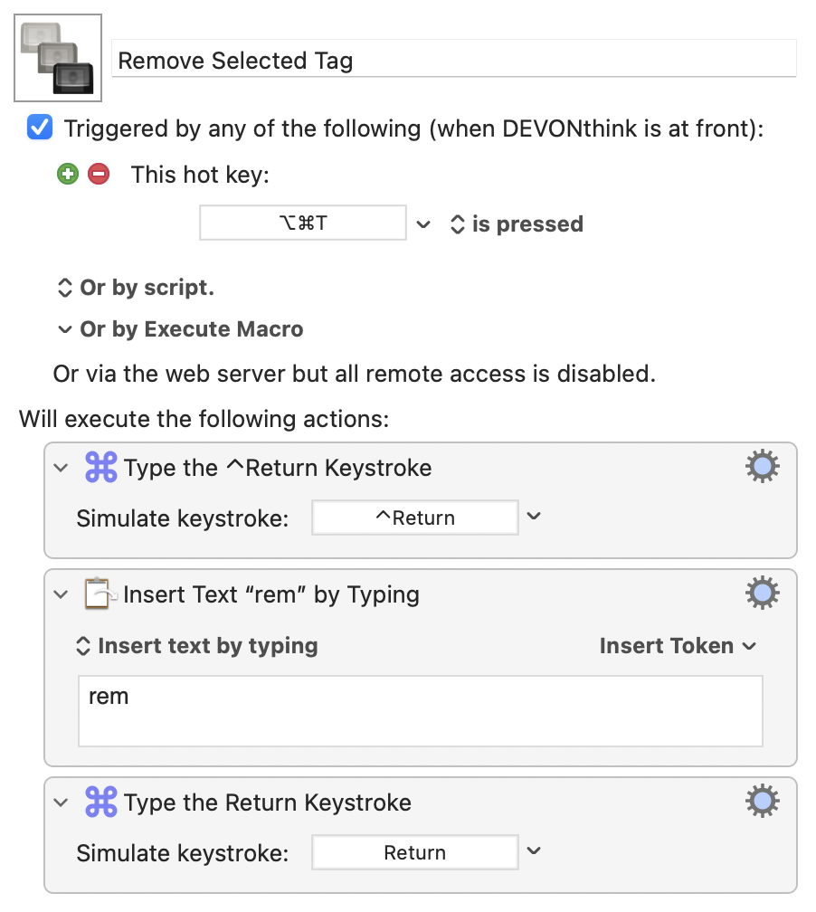

Well as you figured there appear to be multiple ways to do this, although perhaps not exactly what you want. However you go, you’re still going to need to select the tag you want to remove. If it’s that you want to have the tag inspector showing and then select the tag then delete with a keyboard shortcut, you can do this with Keyboard Maestro after you select the tag and then the macro will invoke the context menu, searching for the “Remove Selected Tag”, and choosing that. Don’t know how reliable this is overtime, but here’s one that just searches for the “rem” of “remove” as that’s unique in the current context list.
