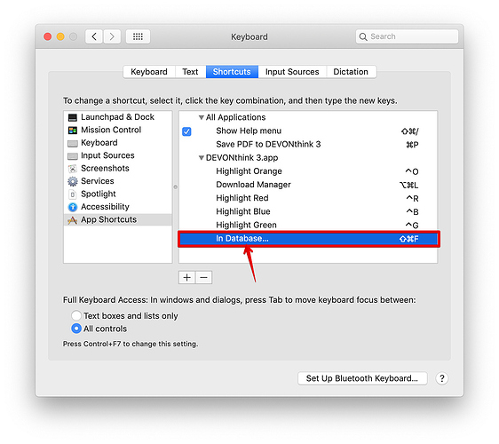

No, you can’t reset to DEVONthink 2 behavior, but you could assign a hotkey in System Preferences > Keyboard > Shortcuts > App Shortcuts > DEVONthink 3.
PS: That’s a true ellipsis, Option-semicolon, not three periods.

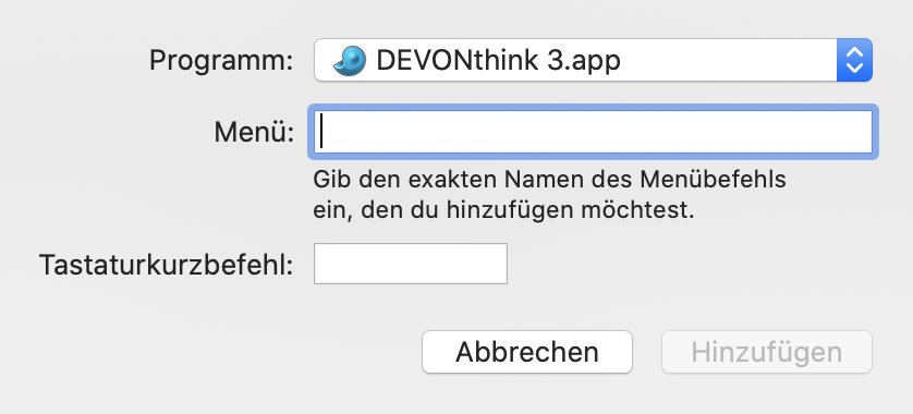

Sorry - how do I get it into? (My view is empty and if I click on the “+” it asks me for the exact menu command. Thanks a lot in advance,

Yes, you need to type in the exact menu command. That’s why I mentioned the true ellipsis. and it needs to be designated for DEVONthink 3, not All Applications.
