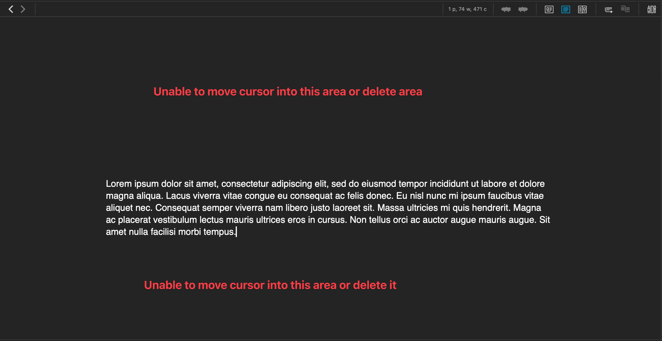

Large blank space top and bottom of markdown preview window
Background information
I am running DT 4.1.1 Pro under macOS 26.2. I use markdown extensively and rely on DT’s inbuilt CSS for rendering it.
The problem
When I create a new markdown document (not using any template) there is an extensive area at the top and document in preview mode (only) that I am unable to access or delete.

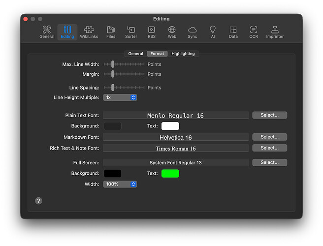

My settings in DT Settings → Editing → Format are:

Did you enable typewriter-like scrolling? Then this is intentional and required.
Idiotically, and inadevertently, yes: thanks so much for the kind, prompt response—sanity has returned!
