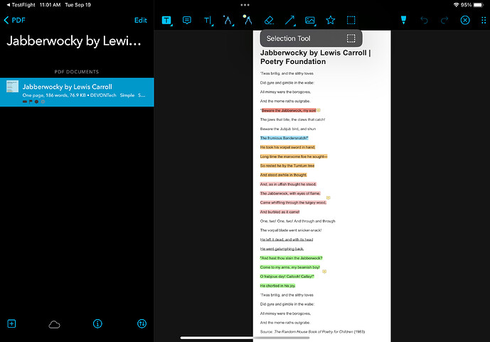

Welcome @denosawr and thank you for the kind words!
There isn’t a lasso but there is a marquee selection tool that works with freeform annotations, like those made with the pen…
It does not select text or text highlights.

The marquee tool only requires touching the edge of an annotation to select it. It does not require fully enclosing it. Also, freeform annotations placed close together will be joined as one. I don’t know if we have any control over that as it’s a third-party framework we use.
