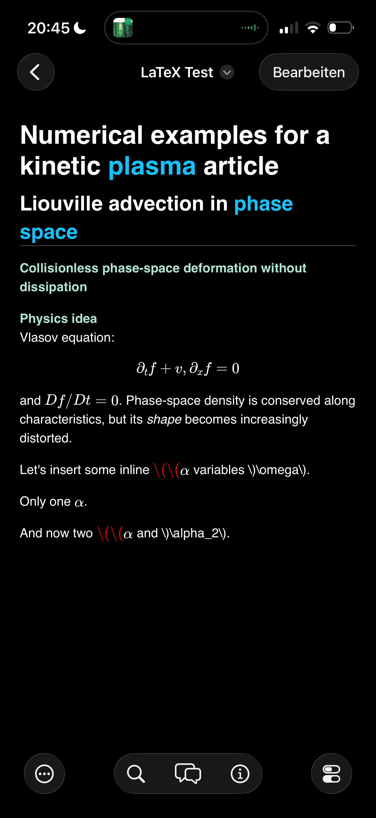

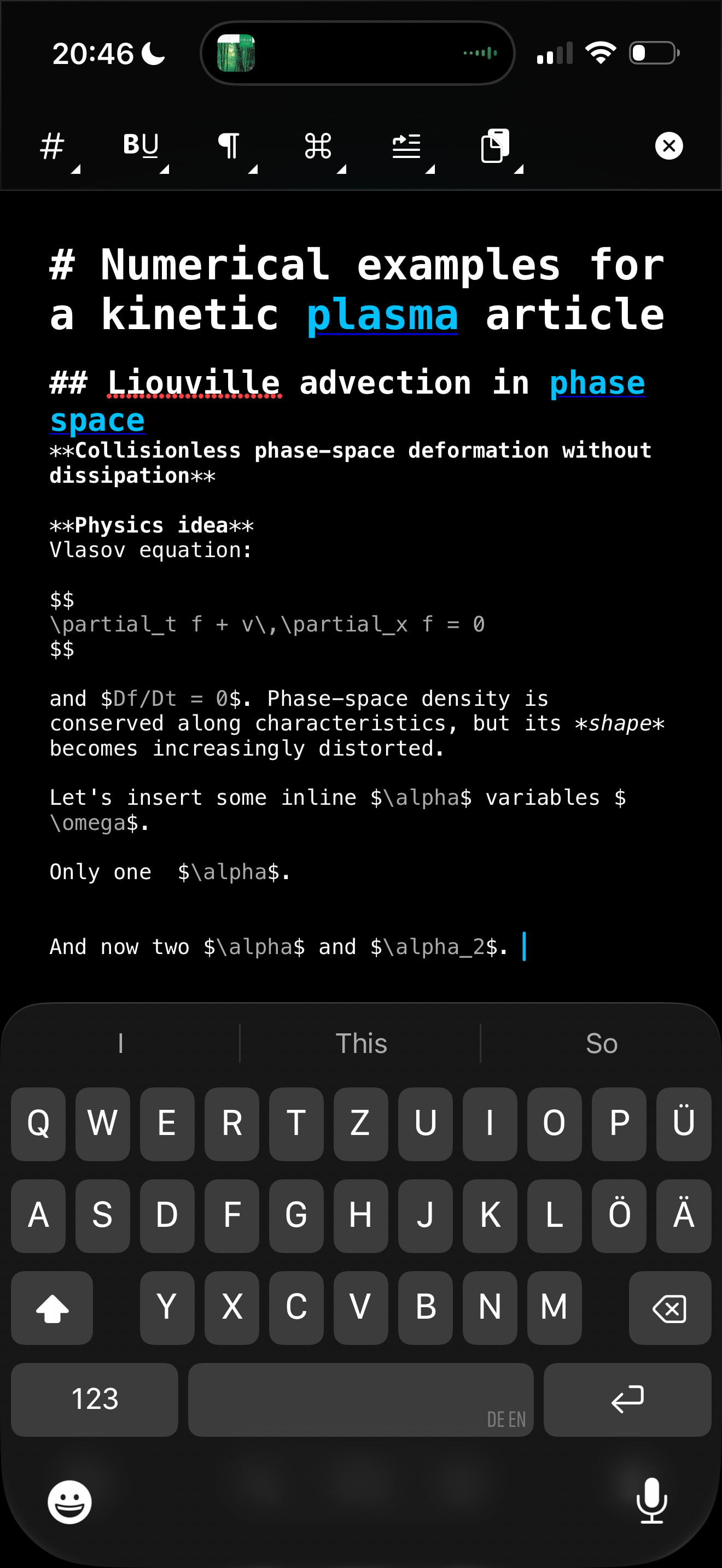

In DEVONthink To Go 4.0.3, inline LaTeX expressions are not rendered correctly in Markdown notes.
Inline math written using standard $…$ syntax is displayed as raw, broken LaTeX code instead of being rendered. This issue occurs when more than one inline LaTeX expression appears within the same line of text.
In contrast, display math using $$…$$ is rendered correctly.

Unfortunately, the update to DTTG 4.0.4 did not resolve the issue, and this week’s update of the desktop app to version 4.2 has now also broken LaTeX rendering there.
