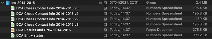

What’s the size of the files according to the Info inspector in DEVONthink? Is another attempt to verify & repair the database successful? If not, are these indexed files always locally available?
Thanks Christian. DT sizes are same as Finder:
