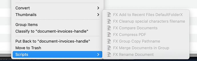

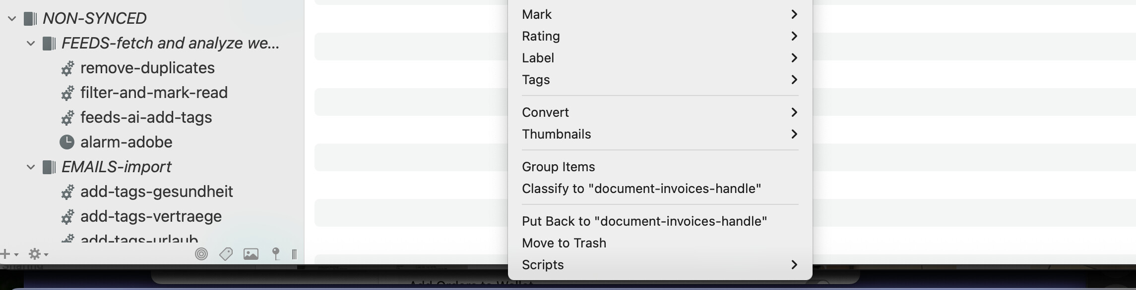

Today, I encountered a situation where I was unable to run scripts because the menu was greyed out. From other discussions, I know this happens when another script is already running. Unfortunately, I couldn’t determine which script or automation was currently active.

The problem

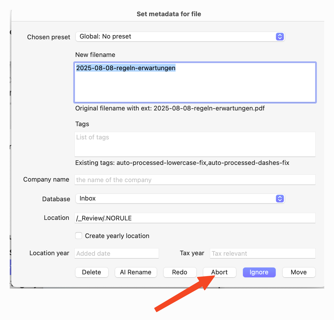

  1. I applied a rule
  2. The script showed a dialog (Dialog Toolkit Plus via DT) and I decided to abort the execution of the script with a handled exception
  3. 	if theButtonPressed = "Abort" then
    		-- no: close theWindow to make review and handling easier
    		error "Abort handling of documents" number 1000
  4. The indicator was hidden, but as seen in the screenshot, there’s no “Apply rule” and starting other script was not available.
    Somehow the script didn’t stopped.

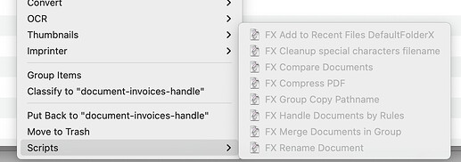

Narg… Still a problem… Scripts are all greyed out.

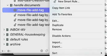

@cgrunenberg Even for “On Demand” smart rules? I’ve got a fixed subset of documents I want the the script to work on. A “workaround” would be using a smart group + a normal script from the contextual menu.

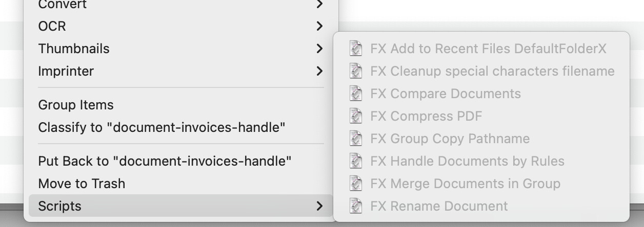

BTW: Running the same code as “Script” works fine. I can start the script again. If I add the same startup code to an “On Demand” smart rule, the script sections is still greyed out after the script finishes. Any idea?

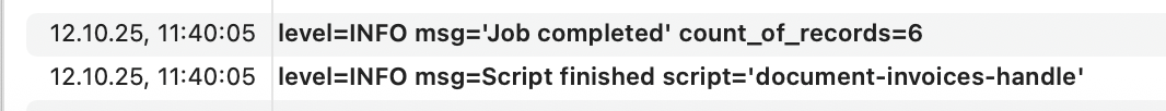

From the logs I can see, that the script finishes
But the script menu is not activated again.

Is it still disabled after waiting more than 5 minutes? That’s the timeout DEVONthink uses for frozen smart rule scripts.
No. After 5 minutes the menu is accessible again.

I see this in the logs:
So, the method runs completely, but somehow DT thinks the Smart Rule is not finished.

When
	set {buttonPressed, controlsResults} to display enhanced window "Set metadata for file" acc view width accViewWidth acc view height theTop acc view controls allControls buttons theButtons initial position {} giving up after 0 with align
is run, the smart rule never ends. I rebuild my setup based on your suggestions.
