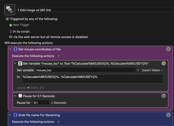

One other thing. To start the macro, you need to have the file selected in Finder. Leave the mouse at the position where you selected the file (so that it can drag the file into Devonthink).

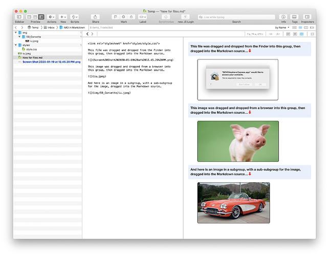

Why don’t you use the method I describe, using a group to contain the file and assets and using relative links, no different than web pages do?
Make a group.
Add a Markdown doc.
Drag and drop your image into the group - or a subgroup, if you want to use such a structure (I do).
Drag and drop the image into the Markdown source and the link is inserted.
In fact, now that @cgrunenberg added the drag and drop into Markdown like this, I use this method even more… every single day. (And yes, I used to type the links out, and still find that to be an acceptable way to enter them. )

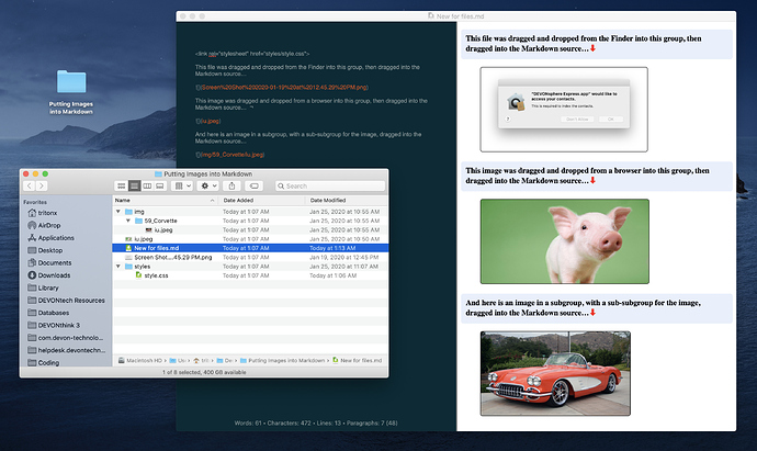

I actually like the method @BLUEFROG suggested (but I use safari).
I tried it now and it makes a lot of sense. I even exported the whole groups via the export files and folders and opened it in Bbedit and the images rendered well!

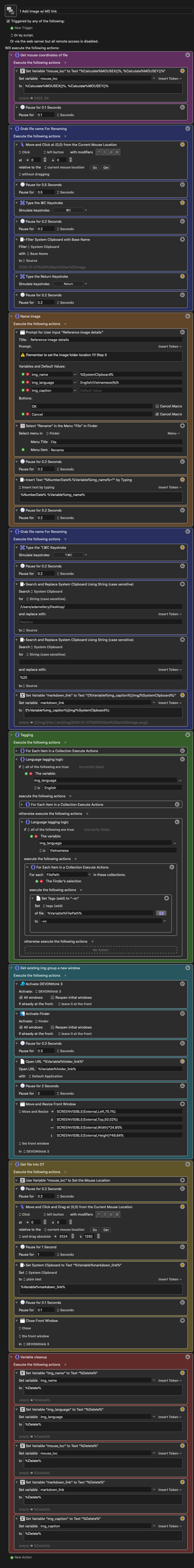

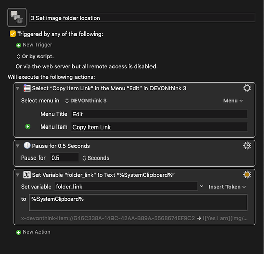

the only issue is how to automate it in terms of maybe a quick way to convert an existing .md file to a group and putting that file in it, while also creating a imd folder in that group. That would make things a bit easier when you repeat that.
perhaps an apple script could fit? Or maybe I can play with keyboard maestro but @BLUEFROG suggested in multiple occasions its better to script rather then use GUI macros ;d

even when you are doing your way, it isn’t viewable by other apps, is it? those relative paths don’t work in other apps
That is incorrect and easily proven.
My method is no different than creating a standard web page (which is ultimately what Markdown is rendered as).
If you use the Item Link (x-devonthink-item://), then you are correct. Those are not going to act as valid image links outside DEVONthink. But they’re also not static URLs either, so don’t use them if you’re going to work with the files outside DEVONthink. Simple.
