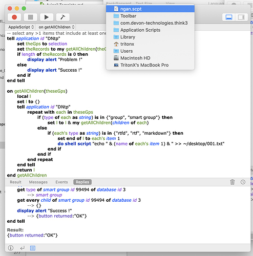

I modified the code to log the found entries.
if (each's type) is in {rtfd, rtf, markdown} then
   set end of l to each's item 1
   do shell script "echo " & (name of each's item 1) & " >> ~/desktop/001.txt"
Running the script from Script Editor and from the toolbar button yield different results.

It was reporting two files from Script Editor and one file from the toolbar.

The toolbar script reports a problem and nothing is logged.
Running the same script in the script edtior reports success and logs two files.
