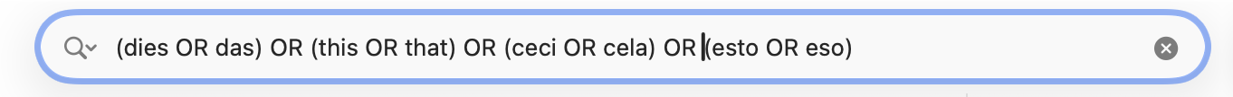

I work, write and gather information in DEVONthink in four languages. That’s simply how my work is, and that’s fine – but text search is a mess. I end up running four separate searches, one after another. I might forget a language and miss important material for what I’m writing.
So I’d like to solve this. My idea: create a German search query with all the search operators, then, with a single keyboard shortcut, automatically translate that entire query (with all its operators) into the other three languages. Something like this:
  1. I type into the search field (in German):
    (German word NEAR/2 German word) OR …
  2. I press a keyboard shortcut.
  3. The search phrase is translated into English and the other two languages, preserving the operators:
    (English word NEAR/2 English word) OR … etc.
  4. Those translated queries are appended to the original German query in the search field.
I have no idea how to implement this. Would this require an AppleScript and a Keyboard Maestro shortcut? Since I have no coding skills, I’d probably have to rely on something like Claude Code to generate the script.
Does anyone have an idea how to do this?
Any help or suggestions would be greatly appreciated. Thanks!
Or DEVONthink’s script assistant (see Data > New > Script… if a provider is configured in Settings > AI > Chat). Maybe a little bit bloated but seems to work:
