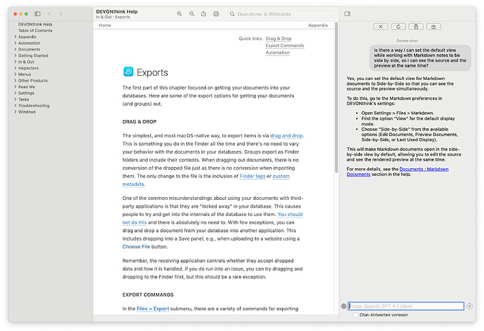

It is easy to miss all the many details DEVONthink has to offer, even with a comprehensive manual that we refer to - I know I do. One thing that’s helped me recently (besides the forum here) is to use the new AI capabilities of DT4 for help. I just tried your question as a test (used gpt-oss:20b but you could use others). With the web-search enabled, it provided this very forum thread as the answer. If web-search is disabled, it still seems to have access to DEVONthink help manual. It was actually faster than the web-search test:
Is there a way I can set the default view while working with Markdown notes to be side by side, so I can see the source and the preview at the same time?

It’s even integrated into the help viewer and doesn’t require or use a web search:
That’s great! For some reason I didn’t even see the side panel when looking at help.
What’s interesting as well though, is that if ChatGPT is selected as the “AI”, then I can ask a question, but if Ollama is selected, I can’t type into the prompt field.
Only commercial providers (except Perplexity) are supported and a model which is both suitable and inexpensive like GPT 4.1 (Mini) is automatically chosen.
